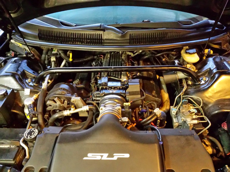

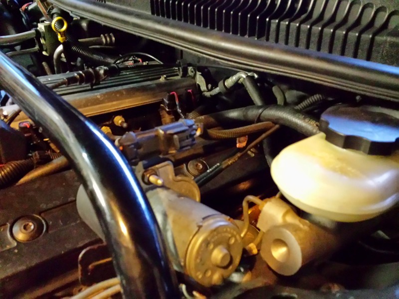

I know the LS1 boys have a very easy relocation for their motor. I have always wanted to try something, so I unbolted it and made a little bracket. It sits under the strut tower bolt and really sits nicely. Just making room for my LTCC
BEFORE-
AFTER-

You don't have to put the LTCC coils on the valve covers.
Much cleaner up top:

Oh I know they dont have to go uptop. I just really wanted the traction motor off the VC. I now will start exploring the coils location

The traction control can also be mounted behind the drivers side hood strut support kinda wedged into the small cubby hole in the corner of the bay with the cables running between the master and booster

I like. Looks like it may be in the way of accessing the plugs but probably just remove it from the bracket for that. The spot mentioned by spcearle sounds good too. I also like the LTCC conversion too. Someday.
