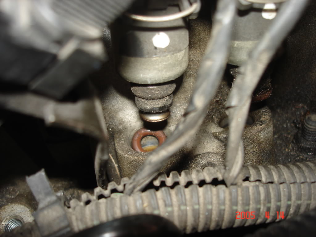

ok so ive been trying to figure out why my car is running really rich my topic here https://www.camaroz28.com/forums/sho...d.php?t=626790. Was told to check for leaky injectors regualtor ect. well I pulled the fuel rail and none leaked, but one of the injectors had something hanging out of it like a circular thing, and it was only on one of them it was cyl. 1. So is this one bad or is it supposed to be like this? I was gonna go buy new ones but thought i check here first I can get a picture of up if you need to see it. Thanks

heres a pic now i can see what looks to be a O ring in the hole...but it doesn't leak.

That is the o-ring that needs be on the tip of the injector to seal the inside of the intake from the outside. Pull your rails and put it back on.

haha lol I was wondering why when I put it back on the first time it had a really bad hissing sound and ran like crap lol didn't see the ring until I stuck the camera in there must have popped off when i pulled it out the first time yesterday..thanks man

No problem post up if that cures your problem. They get so stuck to the intake that when you yank the rail up many times they don't come with the injector...
