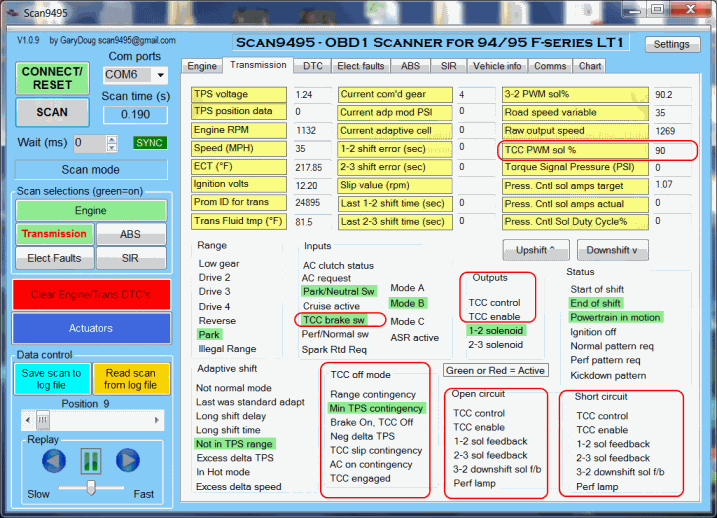

The PCM provides a lot of information about the transmission, including the TCC control and reasons that it is turned off. Note everything pertaining to TCC or shorts or opens in other solenoids are circled in red.
Attached Thumbnails Pulsating rpm while cruising-scan9495-transmission-tab.png

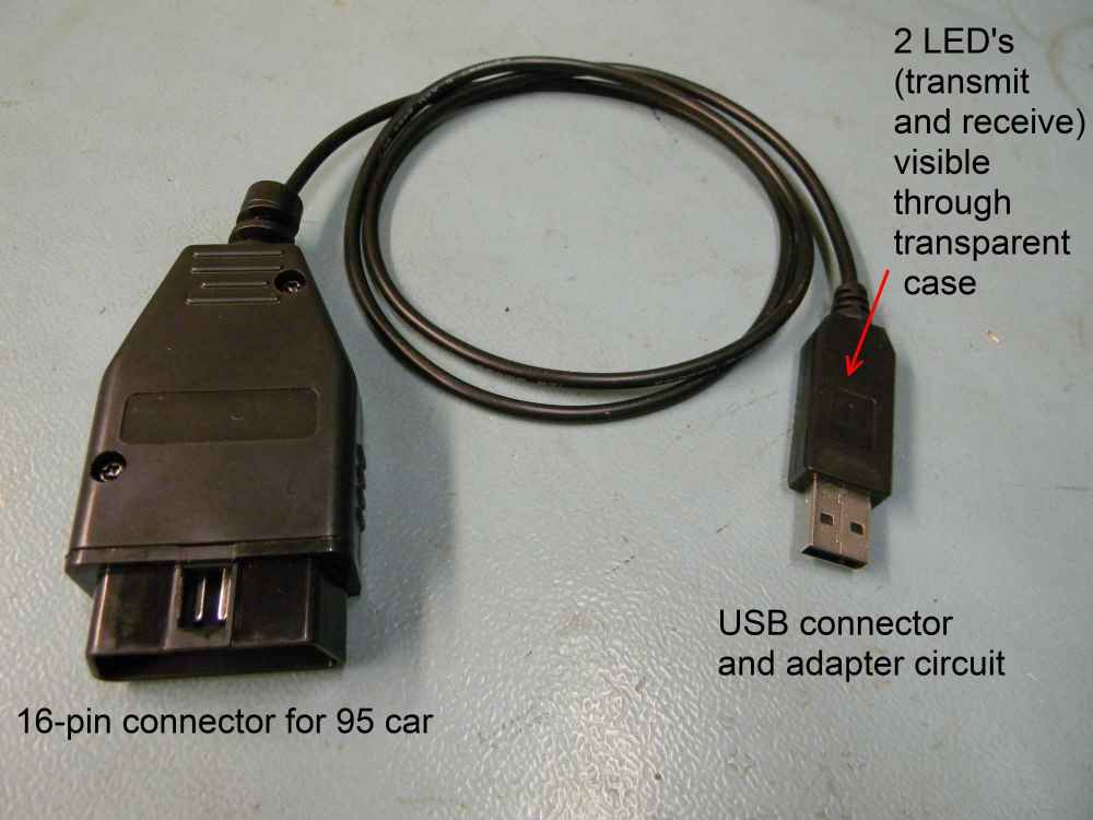

Garydoug, is there any way to test my USB cable to see if its bad. Your program and the drivers for the usb installed but i cannot connect in the scan software.

Depends on the cable. If there are lights on it, you can do this: Plug it into the car's connector and switch on the ignition. The red LED should be flashing continuously. If it isn't the cable may be defective or miswired.

Yeah, it doesn't have a light. I'll try installing everything again. Hopefully i can Get it to work.

Many interface cables get powered from pin 16 of the connector, which is provided via the cigarette lighter fuse.

OBD1 cars don't use the power from the DLC socket. Even OBD1 handheld scanners have to get power from a cigar lighter plug or ac adapter. These OBD1-USB adapters get their power from the pc. I have never seen an OBD1 adapter without some lights. They may not be visible until lit through the translucent case. The ones I specified in my posts are like that. Normally they flash green and red briefly when plugged into the pc. Then they flash red if plugged into the car with the ignition on.
