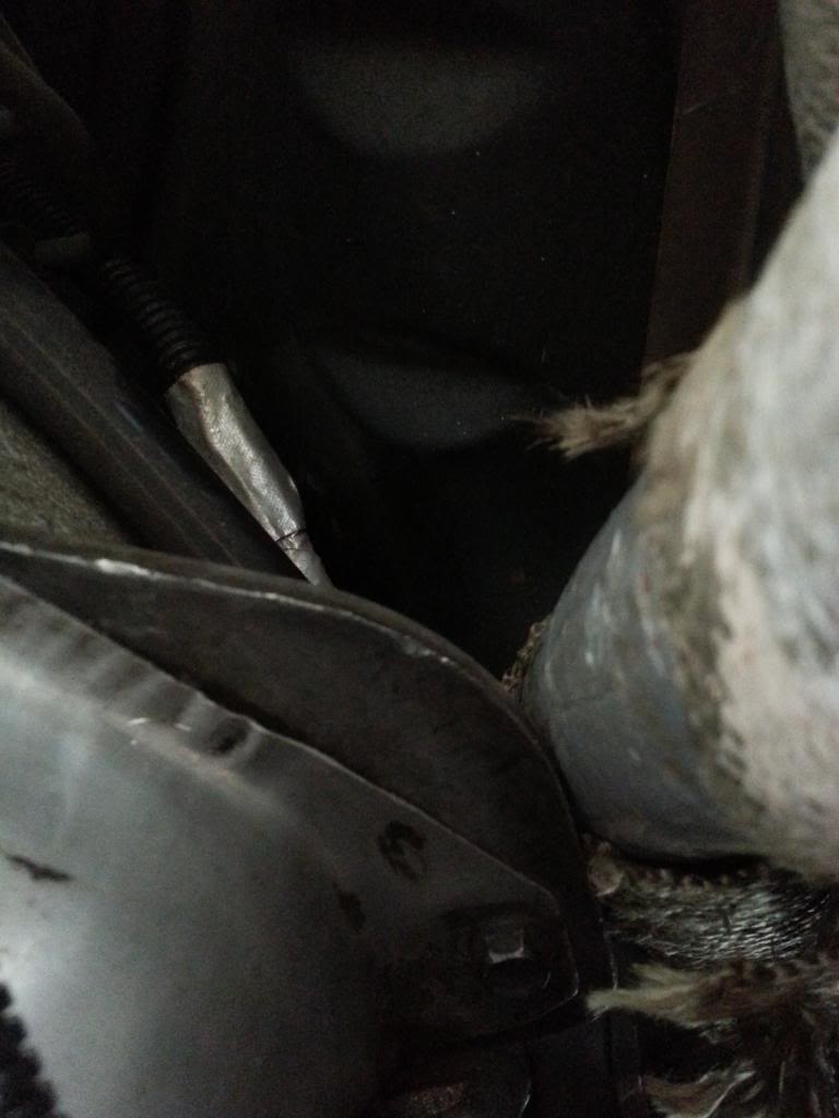

Thanks for the response. Went back to look around and see if anything was touching to cause real knock (even though I can't hear anything). And I found this...
This is the passenger side transmission flange. I'm going to hope and assume that this is what is setting the knock sensor off. It seems to me that I would be able to shave a little off that flange to where it isn't touching the header. Or would that not be wise?
