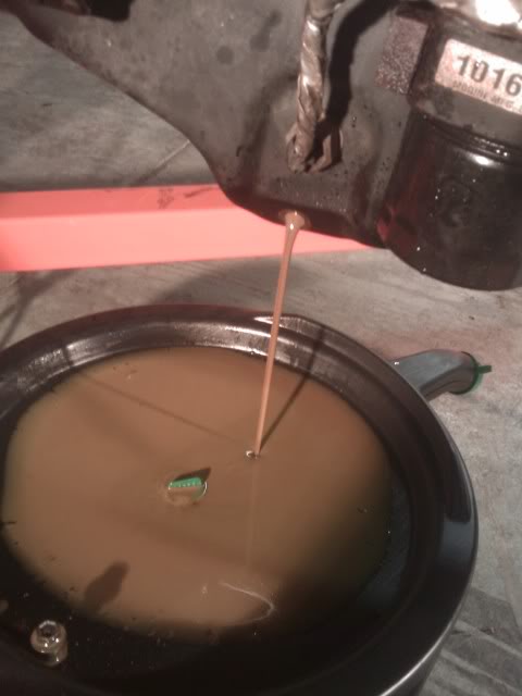

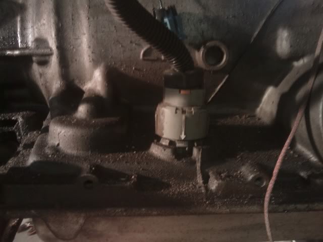

which sensors are these connectors for? and how the hell do I remove them without breaking them? PS if your oil looks like this, time to buy a new engine =)

Originally Posted by GhostZ28
The first picture is your oil level sensor - there's a clip plug that plugs into the end of it. Here's an e-bay auction link showing a brand new LT1 oil level sensor and you can see the end where the plug and clip go. That should give you an idea on how to get the plug unplugged on yours.
http://cgi.ebay.com/ebaymotors/92-03...#ht_1909wt_799
Here's a picture (courtesy of Shbox) that shows the oil level sensor plug:
http://shbox.com/1/harness8.jpg
Second pic is the knock sensor plug - squeeze each side where the arrows are to make it an oblong instead of perfect circle and it will pop off the knock sensor.
Isn't that second pic the plug for the transmission electronics?
But removing it is as stated- squeeze to elongate...

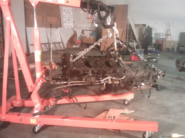

Thanks a lot! The low oil level is a PITA whats the trick? I used a combo of yanking the wires and a tiny screwdriver to pry back the retaining clip or whatever you'd call it. by the way, look what I ended up buying to make this whole thing easier..
Yeah you know looking at it again you're 100% correct - that's the transmission plug. Knock sensor is more oval shape.

"New"/90k mi engine came in today! I hope to get the transmission bolted up and the whole thing secured to the kmember before I get too tired to work anymore
