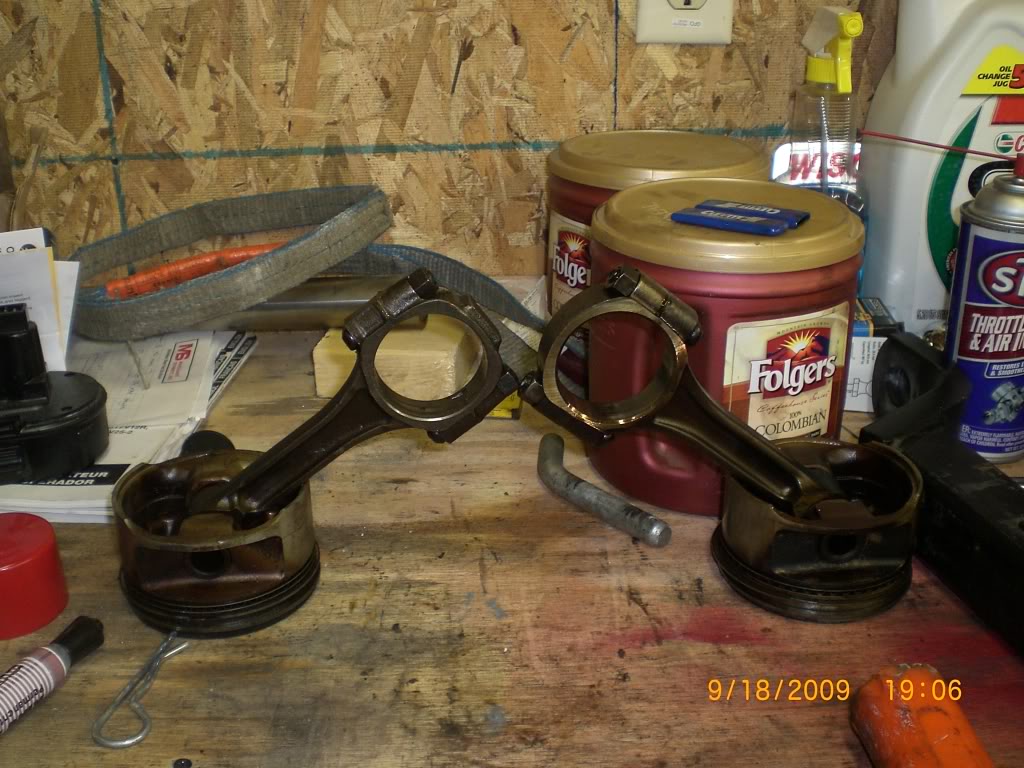

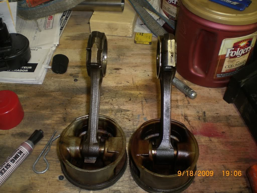

From what I have read PM rods weren't in use till late 94 and were in all 95 and up lt1's. The lt4 has PM rods but has a cracked cap and the lt1 rods have a machined cap.
The rod on the left is from my original z28.It is a 94 z28. From what I can tell, it is a plain old forged rod. I am assuming this based on how it looks and the pad on the big end of the rod. This rod has GM cast onto the rod. Here are the pics:

The rod on the right is from a Corvette with a 4-bolt main, as all are. Is that what a PM rod looks like? It certainly is different than the one on the left and it is from a 96' engine. This rod has no GM markings. The rod is NOT an LT4 rod, no cracked cap.
I want to reuse these rods , if they are indeed PM rods.

You are correct - the one on the right is the PM rod, GM didn't use cracked caps until the LS motors.

I have seen from several sources that the LT4 uses a cracked cap:
http://www.enginebuildermag.com/Arti...t1_engine.aspx
I think this is a ditto of the above link:
http://www.lt1.org/lt1tech.html
Thanks for the rod id!

you're right - I forgot about that one.
Cracked cap rods are a joke, they get thrown right into the trash when building a motor.
