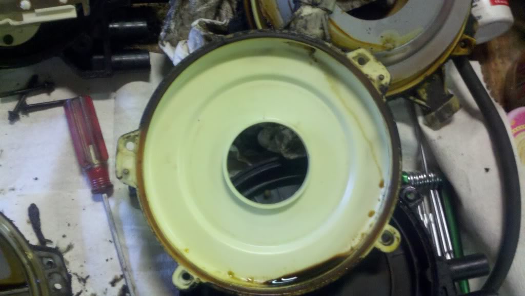

guys, im in the middle of tracking down the "high rpm stumble". so far i have changed fuel pump, spark plug wires, plugs, swapped out coils and icms, and now am coming to the opti. the one i currently have is my original oem with 130k miles. not throwing any codes. i am running a double roller t/c setup. but i pull it off and take it apart hoping to find something. there is a little (looks like oil) trail coming from the optical sensor plug that collected in the bottom of the housing...

so i figured i would swap in another used oem unit to see if there is any change in performance or symptoms. i took a unit off a 96 "baby lt1" that i have been robbing parts off and went to take the cap off but a screw broke, so i set it aside. then i took one off a 190k mile motor that had a broken crank thinking it surely had been replaced in its lifetime. this is what i found... (notice the loose rotor screw)
so i have 2 questions,
1) has anyone running a double roller had issues with the clearance between the cam bolts and optispark?
2) do you think the blown up rotor in the other optispark could have caused the crank to split?

Don't know about the first one, but the second one is possible I would say if the car was actually firing. Watched a video of one explode from the timing being too advanced in a 4cyl motor when I was in college. I don't know how strong these cranks are though. I would think the knock sensor would pick up before that happened though. Just a thought.
