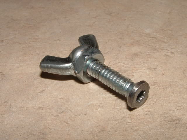

Your local hardware store should have torx screw with a head the same size as the inverted torx screws on the opti cap. One of those, a wing nut and a hex nut to lock the wing nut on the torx screw and you have a cheap opti cap tool.
Oh, you mean this.
Total cost less than $1.50
