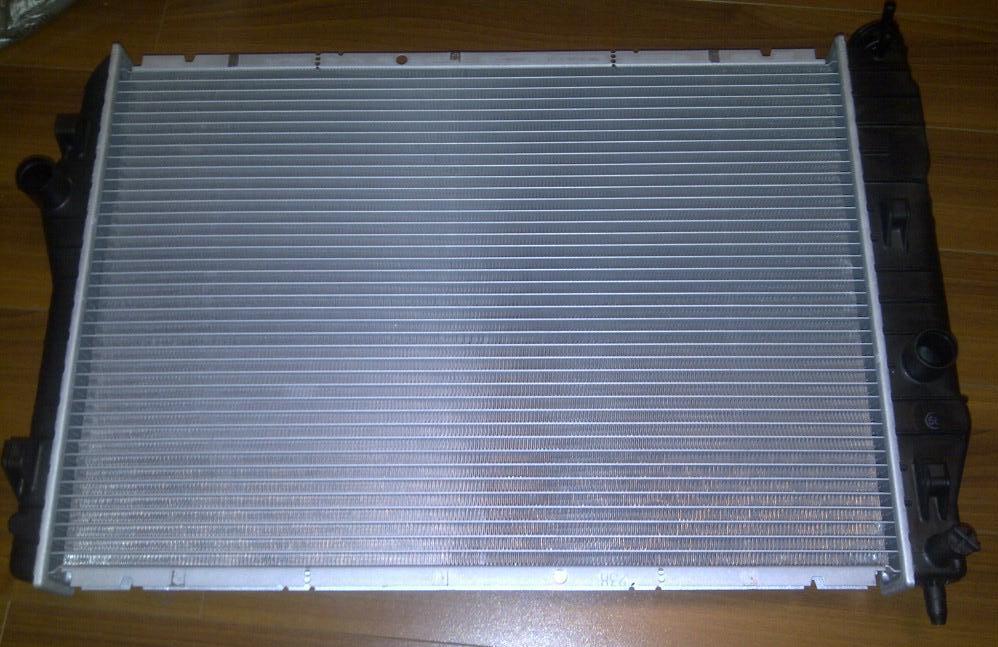

I just received the new Radiator and it appears to be ... wrong....
There are no hookups for the trans fluid, and there is no mounting point for the Temp Sensor... Finally there appears to be an extra port at the top right (or is that the heater hose inlet?)... I was under the assumption this would be an OEM replacement / equivalent.

The very top right leads to the reservoir, the one directly beneath it is the heater hose.
That looks identical to the radiator I put in my M6, but not sure if it is the same on an automatic.
However these are a universal fit for quite a few GM cars, which in that case I had to hack saw a bunch of extra tabs that weren't allowing the radiator to sit flat or stable.

Yeah, that looks wrong in that there is no port for the low coolant sensor, no trans oil cooler and no port bottom driver's side for the oil cooler bypass hose.
