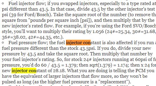

I checked that thread out and he just seems to be having the split blms like the title suggests, not so much them not appearing at all. Although he does use Solomon. Speaking of Solomon, the more I dive into this, the less trust I have in him. For example:
On his websites he explains how to set the injector flow rate if you're running different injectors and/or a different fuel pressure. Well, in my car, the previous owner put a higher flowing walbro pump in it, and i've tested it and i'm usually getting around 46psi with no vacuum. He differentiates fuel pressure flow and fuel injector flow, which confuses me. If you follow his 2nd example which uses stock injectors with a different fuel pressure, i'd take 46/43.5=(1.057) and the square root of that=(1.028) times 24=(24.68) which is lower than than the stock value (making it run richer, which is the opposite of what you want with a higher PSI than stock) of 24.91. I've just always taken that 1.028 number times 24.91 which would put me at 25.61. Not Sure why he separates the two, or which way is right - if anyone can shed light on that.

He's simply saying there are two cases to consider:
1 - recalculating injector flow when the new injector was flow rated at a pressure different than 43.5 PSI.
and:
2 - recalculating injector flow of the same injector when the fuel pressure changes.
Referring to one as “injector flow rate change due to injector flow rating pressure”, and the other as “injector flow rate change due to change in operating pressure” would be clearer.
Not sure why he rounds the stock injector programming as 24 #/HR, rather than using the correct 24.91 #/HR. Maybe it just an “example”, or maybe he feels telling amateur tuners the real GM programmed value would complicate things with the decimal places. The rated pressure of the Ford/Bosch injectors is rounded off also. The rating pressure is 2.7 bar, which converts to 39.15 PSI.
On the other hand the impact of rounding the pressure is very minor. But rounding the factory flow rating causes a significant error.

I figured as much about the two cases. I happen to fall in the 2nd case with stock injectors at a different pressure - but like you said - I was confused as to why he was only multiplying by 24 instead of 24.91. I've just been multiplying it by 24.91 since that is what it is from the factory.

You are doing it the right way.
