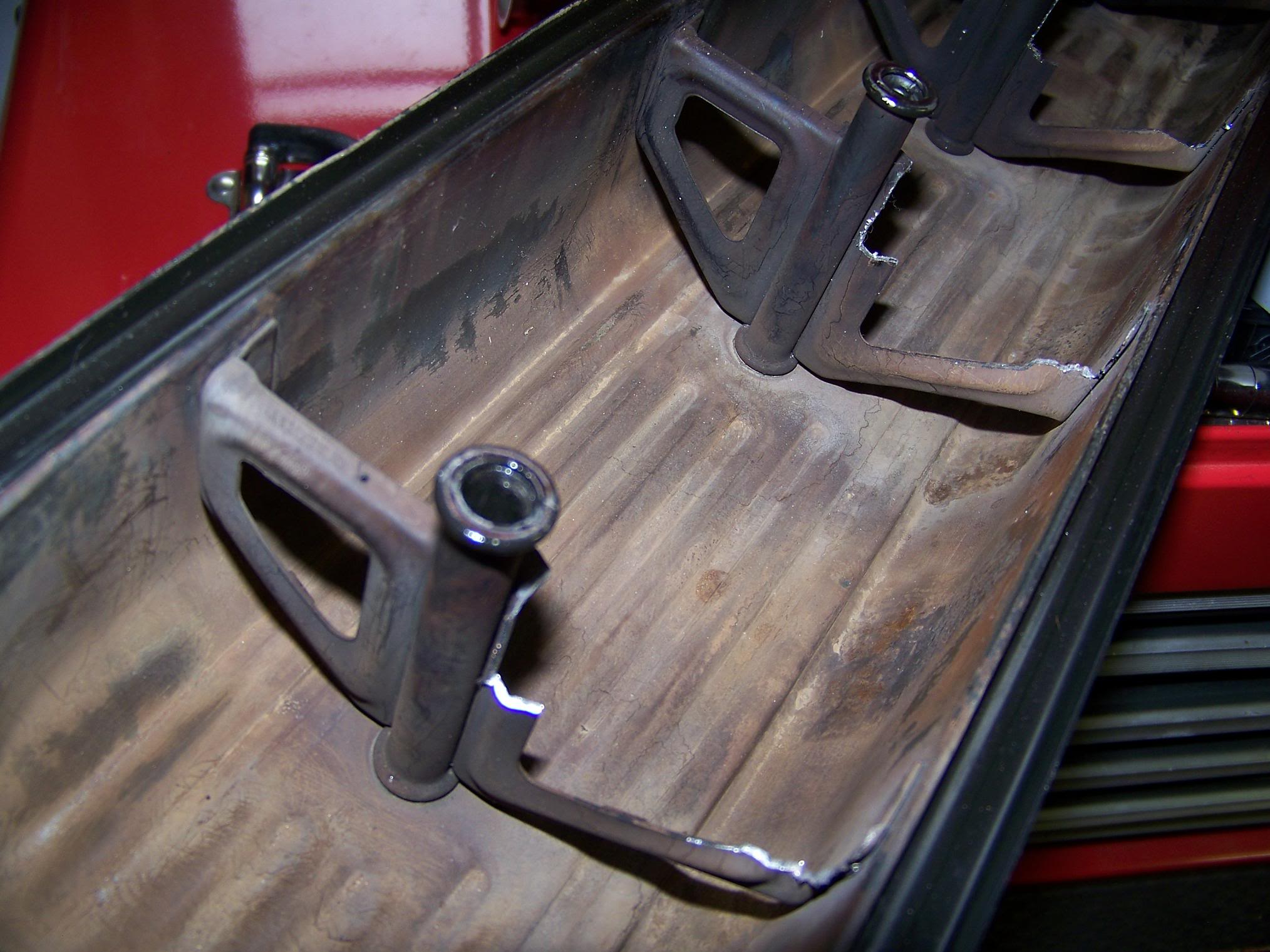

thats what I did.

do you have to cut it down the side of the center bolt hole or just the cross webbing?
Old Feb 17, 2009 | 10:44 PM
Posts: 71,110
Sometimes you can solve the interference simply by flattening out the ridges and right angle stiffeners on the web with a pair of pliers, and not cutting anything out at all. What 1.6 rockers are you using?
