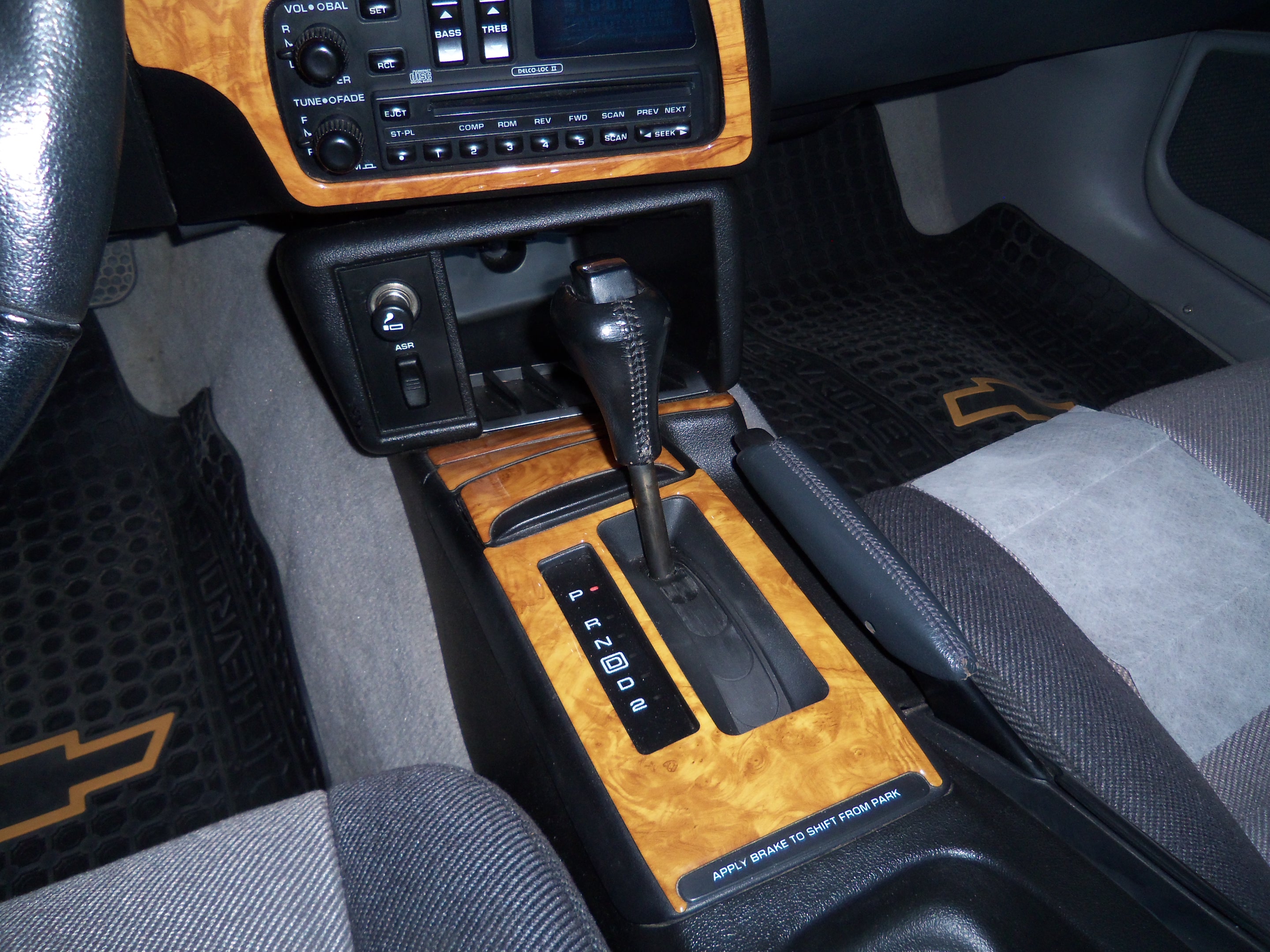

PRND D in a circle and then 2 . would a shift kit do this? Not sure what is one with it. New to me. How would I know if it had a shift kit by observation

Based on the fact that your shifter shows a 2 but not a 1, I can tell you have 2.73 rear gears, not the 3.23 gears that come with the "performance axle ratio" option package.
The shifter should be in the D closest to N for normal driving. That allows the transmission to use 4th gear, which is an overdrive. At 100kph in 4th with the torque converter locked, you should see about 1550 rpm.
If you're in 3rd (the second D), that's a 1:1 gear. At 100kph with the converter locked, this would be around 2200 rpm.
If you were in 2nd, you'd be running 3600 rpm at 100kph, so I don't think that's it.
If your have the wrong D selected, that would be the problem. If not, the clutch bands that engage 4th might have failed, or your torque converter lockup might not be working. It's also possible that the rear gears were upgraded to a higher ratio by a previous owner.
