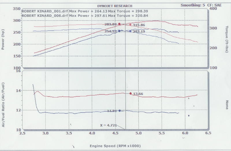

Dyno Graph
Hey guys, forgot that site was password protected, heres another one that not. http://www.ls1tech.com/forums/showthread.php?t=134359

Hopefully the last time
This should make it a little easier: http://www.ls1tech.com/forums/attach...achmentid=3344

From: Mesa, Az
Those #'s are extremely low. How does the car feel? Before it was tuned it was putting down bone stock #'s. Btw, who ever tuned your car tuned it too lean. the car should be running about about 12.8 af at wot to be safe.

LEAN??
Nah I have the last dyno graph. He richened it up a tiny bit to about 12.8 at WOT for the final setup, hp dropped to 294, tq to 319, just to be safe. It feels very strong, will spin 2nd very easy w/o full throttle, first=no traction, havent tried third due to dead O2 sensor.

you havent floores it in 3rd?what gear u dyno it in???

Do you have an A4 or an M6? Just a guess but I'm saying you have an A4 with a torque converter. The torque line is so straight. Or is that just how LT1's are?

From: Orlando, FL
Do you have a CAI? That will probably be worth a good 15 rwhp right there. Ditching those edlebrocks for some LT's and true duals will probably be worth 30 rwhp. What valvetrain parts are you running? Stock 1.5 rockers? Stock springs (god I hope not)? There could be massive gains hiding there as well.

His graph looks nothing like an A4. His car is a 6spd. Lt1's will have a flat torque curve from about 2-4.5k rpms

Again do you know what gear it was dynoed in.
With those mods you should have put down over 350, with that cam alone at least 325,
The cat back is definetly holding back some power, but not 50rwhp. My 3inch flowmaster lost me 3 mph in the quarter, but thats not 50 horse. As for the headers they are not your problem, you have other problems that need to be found.

Gear
The car has an M6 and was dynoed in fourth gear. Yes, I have other problems, but I dont know where to start. Today, i tried to start my car for the first time in 4 days. Is about 45 degrees outside, car would not turn over for several minutes. Left car came back 2 hours later, car started on 5th try, ran fine w/ no surging or weird idle, yet the SES light is still on, even after I replaced the dead O2 sensor. Still doesnt feel like the power it had after the dyno tune. Ill repost this in a new thread. Ideas?
