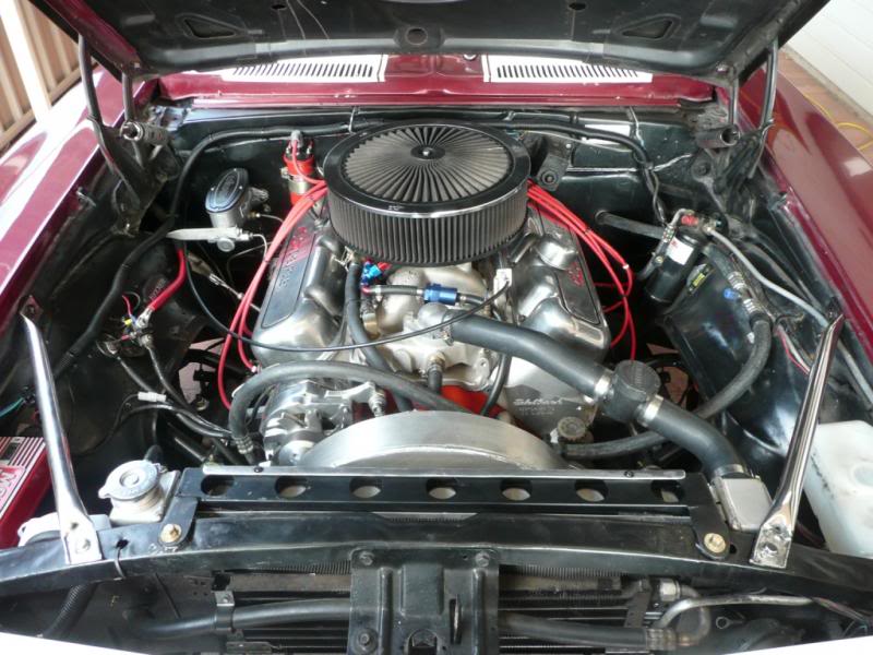

You are welcome. Here are a few more Notice anything unusual?

....I was going to go with the negatives were flipped. LOL. First time ever seeing a LHD gen 1. Nice
I am sure you mean RHD........lol
And thanks. It is not an easy decision to modify a first gen, and once you start, well....hard to stop at just one little thing isn't it?
