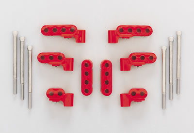

I have been searching for some specific plug wires for my lt1 swap. I installed some shorty block hugger headers and I can't keep the plug wires off the tubes. I'm looking for suggestions on something similar to this.
I have been searching summit and jegs for the past hour looking for this type of valve cover clip with no success. I also don't know the first thing about trim to fit wires but I figure that is pretty elementary once I get them in front of me.
Any suggestions for which plug wires to use on an almost stock LT1? Thanks for any assistance.

thunder racing sell that set up.

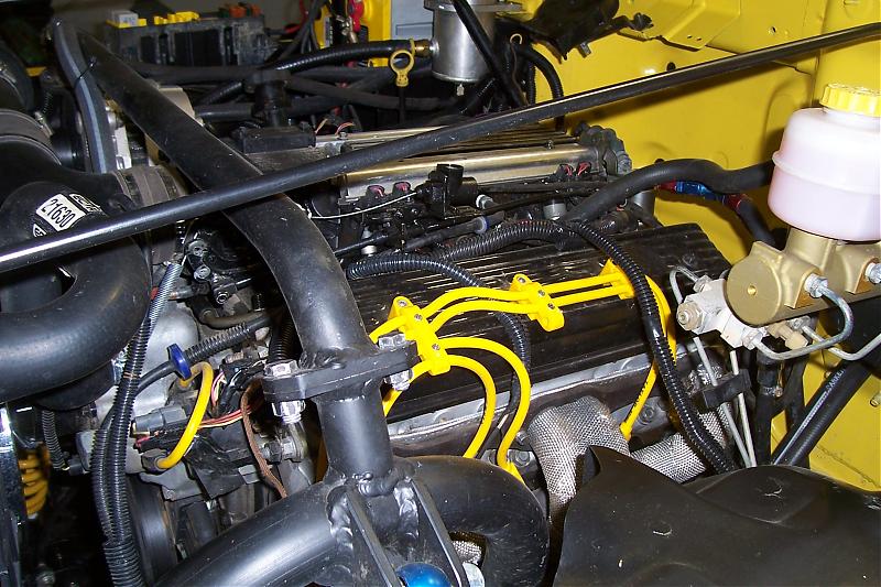

One of the threads below has pictures of a similar set-up. The manufacturer of that loom is a company called Made For You. Several hotrod shops in this area stock them in multiple colors. They work out very well and it's easy to open the holes a little if you want to run fat wires.

Thunder Racing sells the over the valve cover kit
http://thunderracing.com/catalog/?ac...vid=4&pcid=104
and you can go here for some tips on installation
http://www.lt1engine.com/techaids/otcvwires.html
I found their website.
http://www.made4uproducts.com/center...s.htm#Original
I'm going to call them up and order just the center bolt clips and a set of MSD 8mm wires. Thanks to everyone for helping me out! I can finally go drive this thing with out any fear of melted wires! I will post up some pictures in this thread once I get them installed!

Update: She told me to get them direct from Summit to save some money. They were very nice to deal with. I am getting this set here.
http://store.summitracing.com/partde...rt=MFY-5035613
Now I just need to figure out which wires are cut to fit and call it good.
