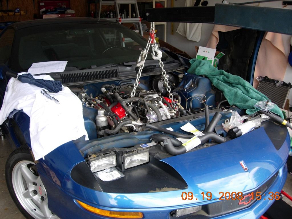

Myself, I would pick up the front of the engine with an engine hoist. This is what i do when putting the engine and trans back into the car. Jack on the trans and a chain between the heads(bolts for chains as short as possible while still fully engaged into the head holes to support the load). Going up with both a little at the time. You would only need the chain across the heads, but I also have off most of the accessories and the brackets removed from the front of the engine when doing it. So, this may not work for you. You also would need an engine hoist with a boom long enough to clear the nose of the car. Again, remember, this thing is heavy so be careful.
A chain on just one of the heads may be enough to lift that side to get the bolts in the bracket.
