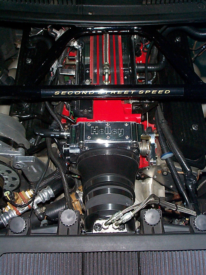

Depends.... the exterior/top side of the manifold is exposed to high temperatures from the under hood heat. You want to keep that away from the aluminum surfaces, so the powder coating would reduce heat gain from under hood. But then there's the heat that comes from the heads (insulated by the gaskets), the block (insulated by the bead of RTV) and from the hot oil splashing on the bottom of the manifold (deflected by the sheet metal pan on the bottom of the manifold. Would be nice if that heat couldget out through the powder coating.
Sort of a standoff....
I never was concerned about it:
