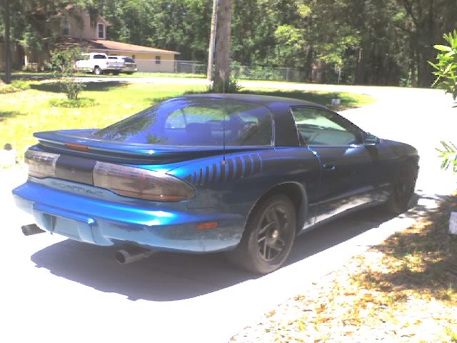

Here she is:
I was worried for 5 months that the car wouldn't look so good in person. It looks BETTER in person!! I actually like the victory striping kit on it way better in person than in the pics.
