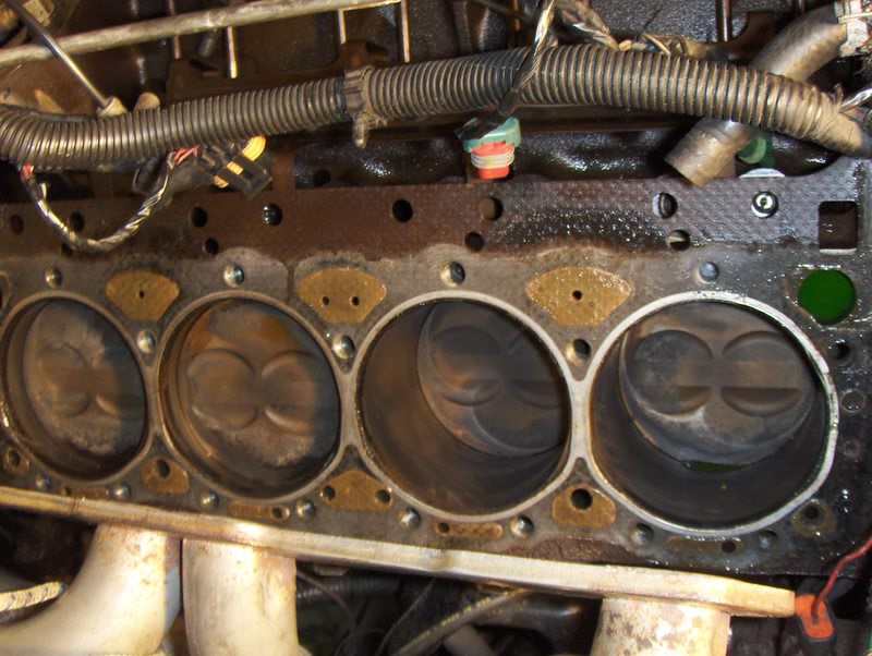

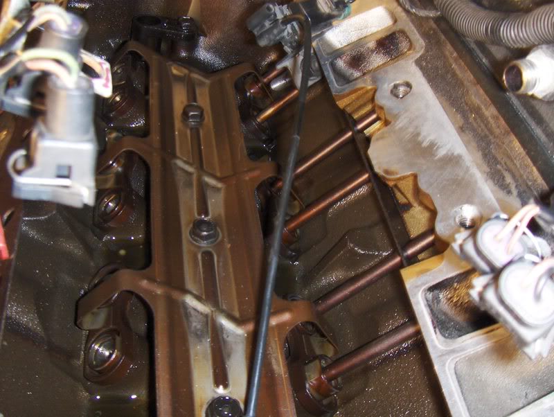

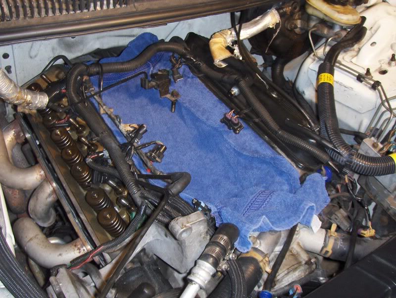

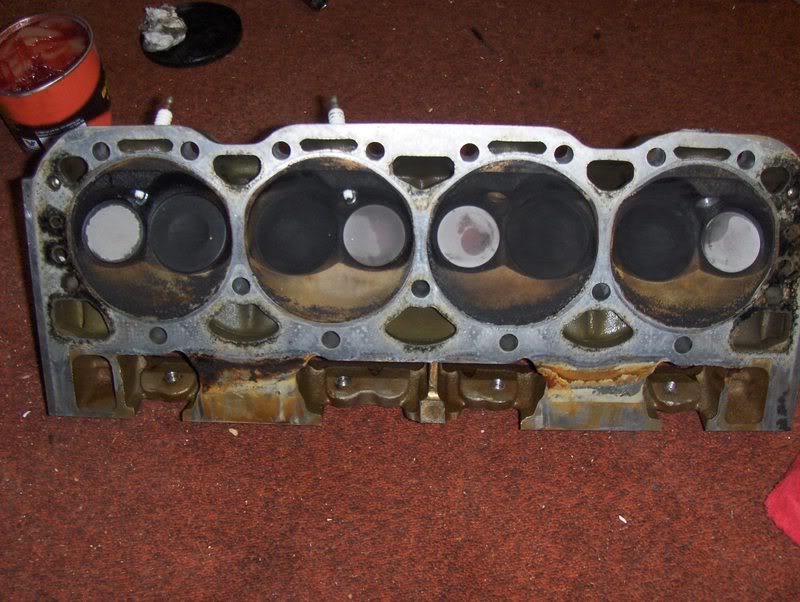

Well heres the progress thus far. I never knew that changing your spark plugs could go so horribly wrong. I've learned my lesson for sure. Here are the pics. Does it matter that i left a bit of coolant in the block? Also what is the process for putting the head back on? New gasket of course, probably going to buy some new head bolts too. Do i have to chase the threads for the head bolts in the block? Do i have to put loc-tite on the bolts or anything like that? Just want to make sure i don't have to do this again. Thanks guys

Appears to be in pretty good shape for 115k miles. No sludge or anything.

On a more serious note. What do you guys do to clean the gasket surface on the heads and block?

I got my heads cleaned up / tested at a machine shop so all I had to do was take a razor blade scraper and scrape the block along w/ some brake cleaner. Ive heard sooo many diff way to torque them, all you need to know is start in the middle and work your way out and do it in 2-3 passes of torque setting

Probably should have absorbed that coolant off the pistons with a cloth or something if thats what you meant by "leaving some coolant in the block". I don't know if thats a huge issue or not but I remember cleaning mine off pretty well after reading that I should during my head/cam swap.

Just remember to start all bolts by hand first before you put a wrench to them

stripped threads, cheap "Back-tap" rethreader broke and peice fell into cylinder
I just chased all my spark plug threads on that head and i should be good to go. Any of u guys use sandpaper or possibly scotchbrite to clean the gasket surface?
Also i had to use a universal to get one or two of the head bolts near the spark plugs off. When im putting the heads back on, how do i make sure i am getting a good torque reading? Thanks guys

Keep sand paper as far away from that open motor, like in the next room. Use laquer thinner and a razor blade.

Ditto, any type of hand worked abrasive it will make the surface wavy.
