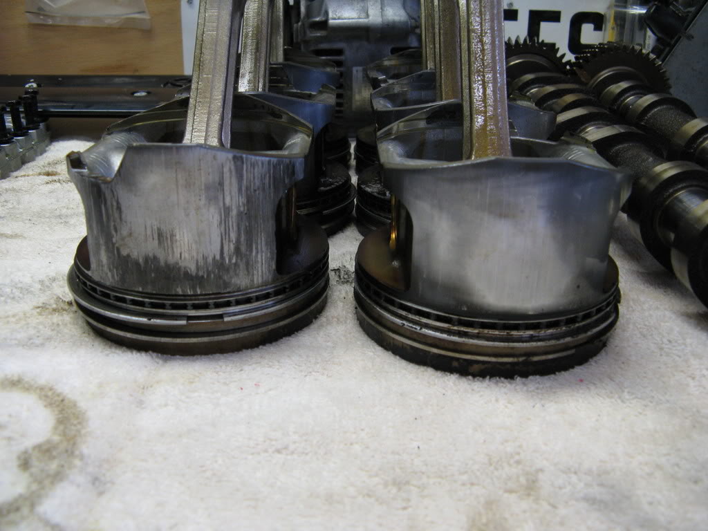

It all depends on the manufacturers...I've yet have to personally experience a "piston slap" on one of my engines. It happens for often with low profile pistons which stock V8's almost all have. Most aftermarket manufacturers have virtually eliminated this with their new tech and more advance materials used for piston rings. Also their pistons are the same with at the top as they are at the bottom which prevents the piston from moving too much with the assistance of rings it eliminates it.
Check this picture out, you can how bottom piston it thicker and all around better built and designed that a stock-er.
To answer your question: (Why it occurs?) It's hard to say, mainly heat would be one reason, constant over heating could cause it, blown ring or spun barring...

These pistons will not stand a chance inside of a cylinder if there is free room to move around...this is what happens, this is what the inevitable outcome of "piston slap" which I don't think this guy has. Like always I'm not saying it isn't its just my opinion and I would hate to see him take his engine down to find out he had a exhaust leak, you know what I mean?
