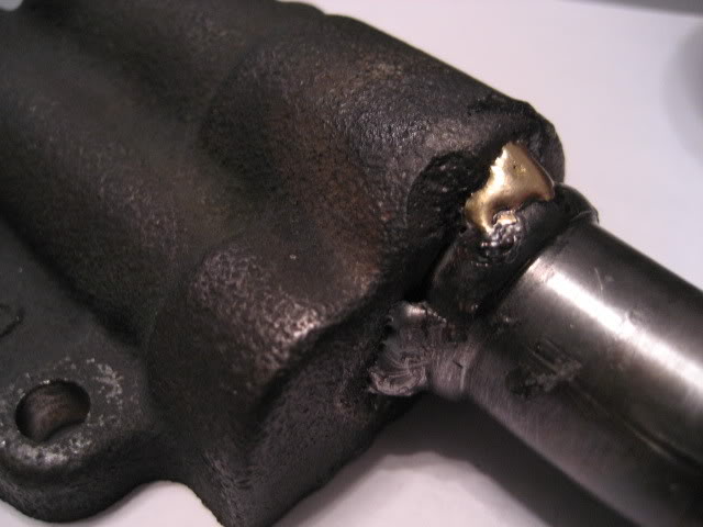

Some additional words of wisdom. Weld or braze the pickup tube on to the pump. Do NOT forget this.
