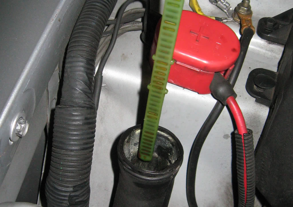

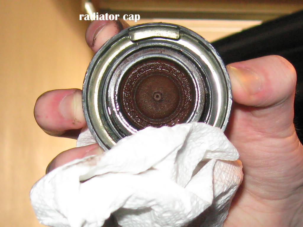

Problem:

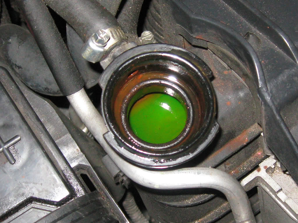

I personally checked the engine fluids yesterday for the first time in probably a year. The coolant looked like reddish orange mud in the radiator, and the level was a little low. My first thought is that some guy at a dealership topped up her overflow tank with DEX-COOL instead of the green stuff during one of her dealership oil changes, and it fouled up the entire system.
My sister took the car to her regular mechanic, and he said that there was so much rust in there that he just drained it and refilled it and recommended we have it drained and refilled every 3 months. He didn't know why it started rusting so quickly.
He said: ultimately, my sister needs to get another car because the engine block is rusting on the inside. The mechanic recommends getting rid of the car or getting it restored. This could end my family's ownership of this car since 1995... which hurts all of us since we have put so much effort towards keeping the car perfect (or so we thought).

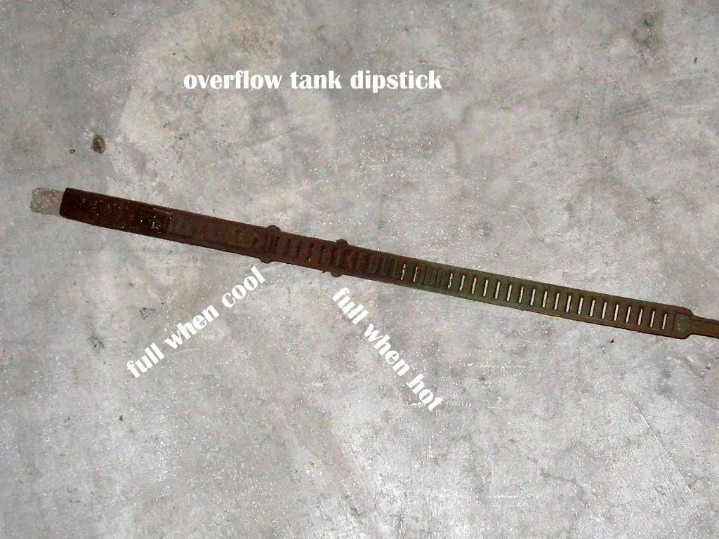

December 2006---~75,000 miles: Coolant level was fine despite continued drip every few days, but there was a little bit of "peanut butter" on the tip of the overflow's dipstick. Since the car was still leaking a drop of lime green coolant every few days, my dad and I drained the old coolant out and removed the old hoses. We changed all of the hoses (except the ones that were changed in 2002 because they looked good), rinsed the system with a garden hose, and put in the green 50/50 mixture it's supposed to have. Air was bled out of the lines that night and the next morning.

February 21, 2010---90,5XX miles: I replace the dirty air filter and worn out windshield wipers for my sister since they were mentioned on her Goodwrench report. Since she hadn't driven the car in about 12 hours, I checked all of the fluids to see the condition and to see if they put enough oil in during her oil change, and to my HORROR, the coolant not only looked like it did in the above pics, but it was very, very low!

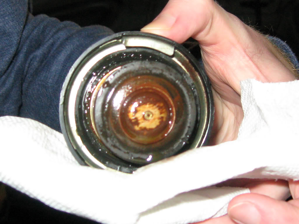

Well, I checked our mechanic's work after the car cooled for several hours and he did a very nice job. The overflow tank has a bit too much in it, but the radiator has a bit too little in it. I suppose it'll even out...
He managed to get almost all of the dried "mud" off the dipstick somehow and everything is nice and green in the radiator. Still some rust, and I suspect the radiator cap would benefit from being replaced. It seems to hold pressure, but I don't have to press down on the '95 one barely at all. It's obviously rusty too, which isn't helping the situation.
I opened the bleeder valves. I don't remember if the car is supposed to be running when you do that or not, but it wasn't when I did it. The top one didn't hiss or do anything. The bottom one by the throttle body dripped a couple of times. Of course, I did this after taking the radiator cap off, which hissed. Maybe 1am mechanic work without my Haynes manual isn't the best course of action...
