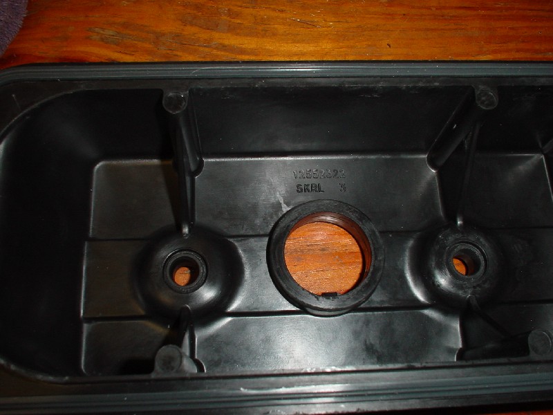

Well I thought my LT4 valve covers would just bolt on. Wrong, there is an obstruction somewhere. I think its the thingy that hangs down and it is making contact with the poly-lock is. See pics.
I have a rather high lift cam with Comp pro-mag 1.6R roller rockers.
Anyone ever run into this problem. What do I trim? Gotta wrap this up tonight.

Those are regular 'vette valve covers, not LT4's. The only real difference I have seen between them is those oil splash tabs. The LT4 covers don't have them. You can cut them off alltogether and you'll be fine.

It could be that you are using the tall polylocks, which will definitely interfere. If you are using short polylocks, there should be no problems.

just snap those off and you will be fine! I had to do it

Ended up trimming after making certain those things I am pointing to were the obstruction. Fit great now. I think the real LT4 did not use poly-locks, thats the difference.
So the difference between LT1 and LT4 composite covers is the drop down tabs. Well I may have paid more for these thinking they were LT4 than I should have. Oh well.

Figured i'd post up a pic to see the difference between them.

Seeing that this has not really been talked about much in the past, I have to think that nowadays that some people are passing off normal Corvette valve covers as LT4 covers. Perhaps not intentional and an honest mistake in some cases, but now the masses know the difference.
