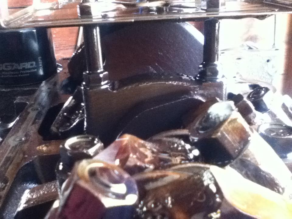

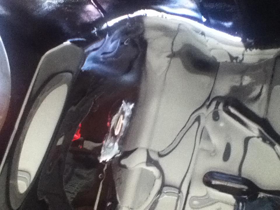

Here's an update, I pulled the trans and engine out today, and pulled the pan here's what I found or...didn't find.
Connecting rod, green marking paint maybe? Is that normal from the factory? I bought the motor used with 70k and afaik it's stock.
Slight scrape on the oil pan 4" back from front seal.
The mark
4" back is shown here.
The journals look good around the edges of the crank, so I'm wondering what you guys think. Ever happen to someone before? Please note the pan was damaged when I received it....and I hammered it out, but that was more towards the rear, I never touched the front as it didn't look damaged at the time.
I will pull the caps/bearings sometime tomorrow just to verify they are alright. Been a while since I took a motor apart for inspection, anyone have a guide to what normal bearing wear should look like?
Thanks

Looks to me that the pan is hitting the rod, put it back on, rotate by hand and check. If it is, beat the pan until it clears.

Weird how it would do that from a stock bottom end. Didn't appear to be any damage from the underside of that area either. Wonder if anyone else had an issue like this with stock bottom end / pan.
Old Mar 27, 2012 | 03:29 PM
sandman2100's Avatar
Joined: Feb 2007
Posts: 293
Re: LT1 Swap into a thirdgen + CC503 - Tin can thunk
Not sure, a lot of those places just yank and either stick them on a tire, or a hand made wood cradle. Maybe they dropped it down hard or someone wedged something in between the oil pan and crossmember to lift the motor for motor mounts, headers etc.... hard to say with yard finds.

Here's an update guys - I think I found the noise....I hope.
Test:
After I pounded it out, everything looked fine with another test using 1/8" glob of vaseline on the pan. I didn't bother checking bearings, as my reliable torque wrench broke and I don't feel any play in the rods or see any damage. The engine is almost fully back into the car, ready to start up again, will post once I fire it up again!
