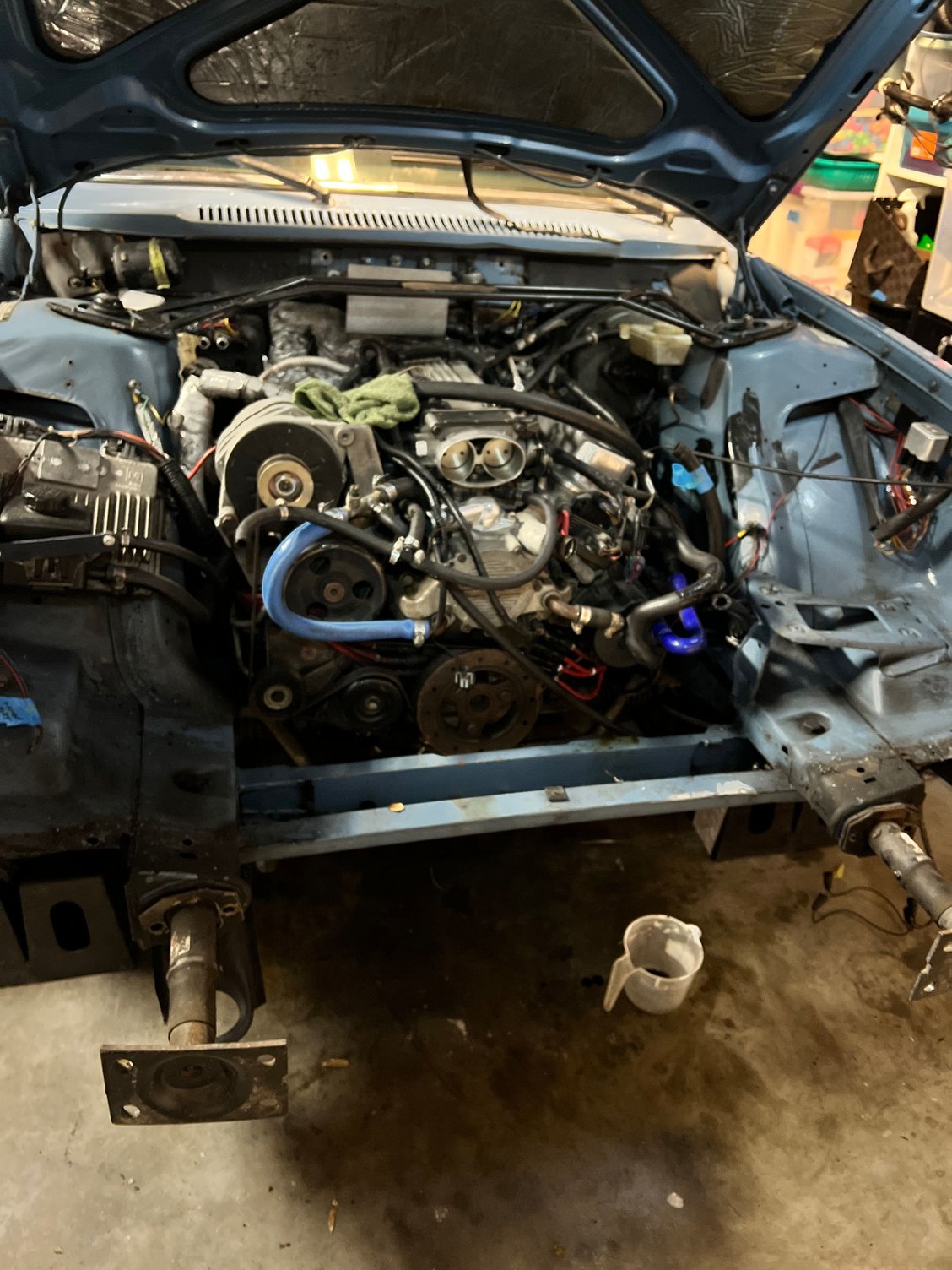

Exhaust, accessories, engine wiring removed, and almost ready to lift out the engine.

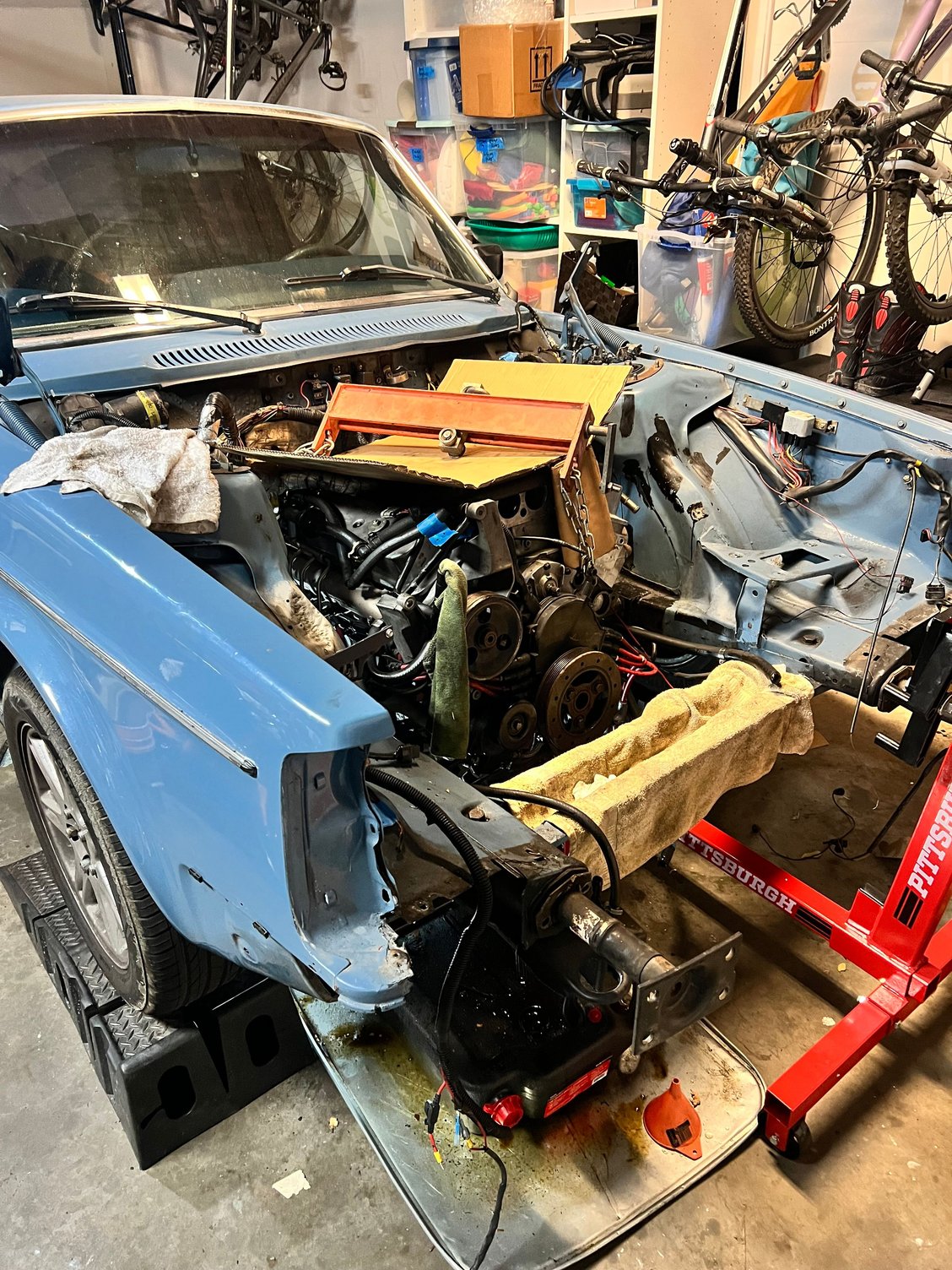

Front bumper, radiator core support and cooling removed.

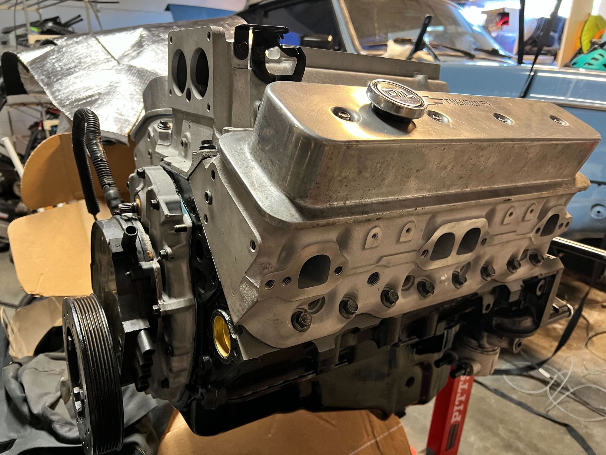

Already a year later...but headed in the other direction. Engine was rebuilt by a local shop, I got great advice Lloyd at elliottsportworks.com and went with the following build:
214/222 .511/544 112 LSA Cam
0.600” springs (145 lb seat)
LUNATI 15345 rockers

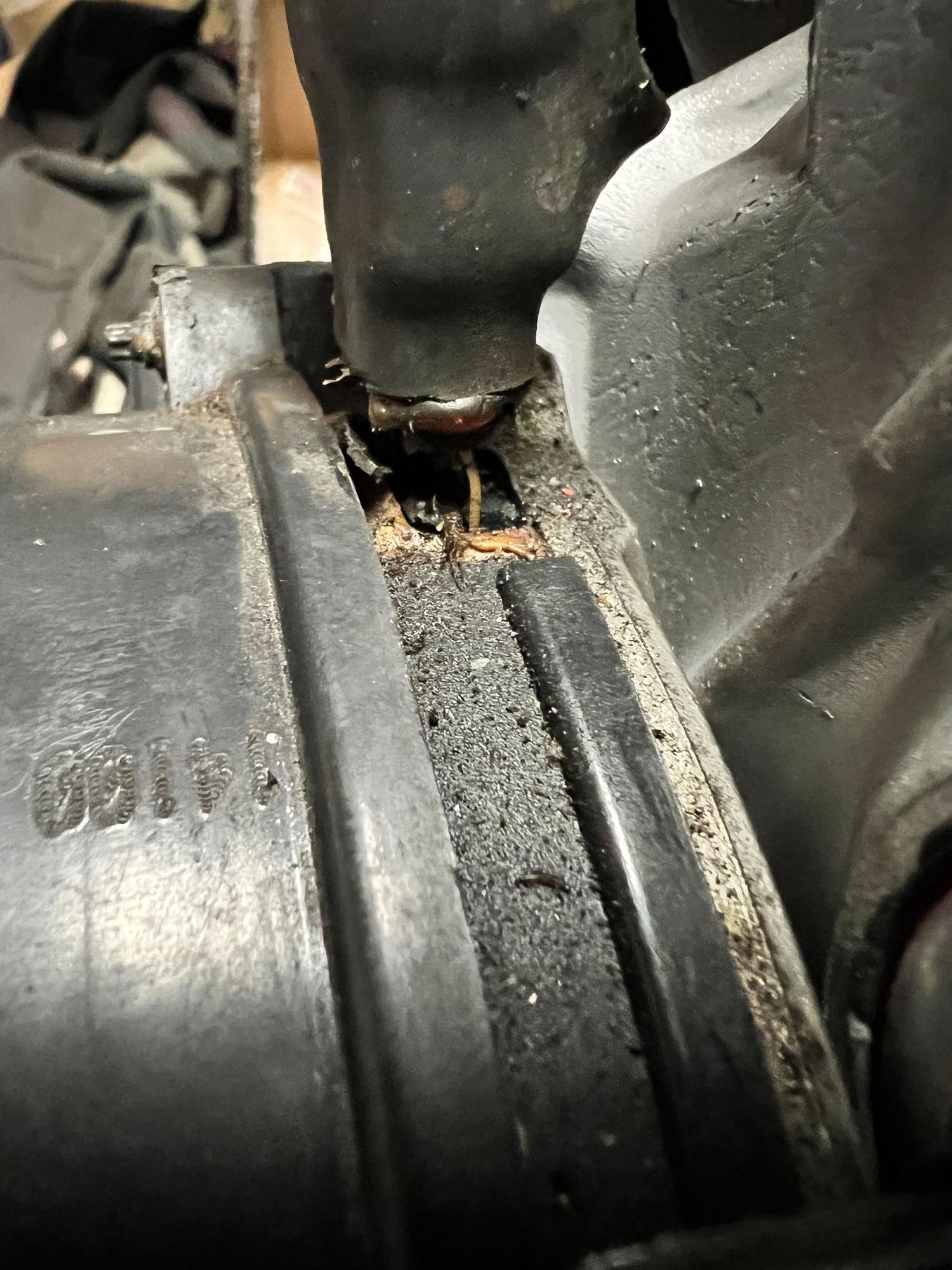

Putting things back together and noticed the Opti is damaged. This may be the source of a surging/lugging I sometimes had from a stop before the engine went.
Harness connection is damaged with wiring exposed.
Looks like the Petris unit is no longer available or at least not currently. Sounds like the MSD unit is not reliable. Any other recommendation for where to source a reliable Opti?

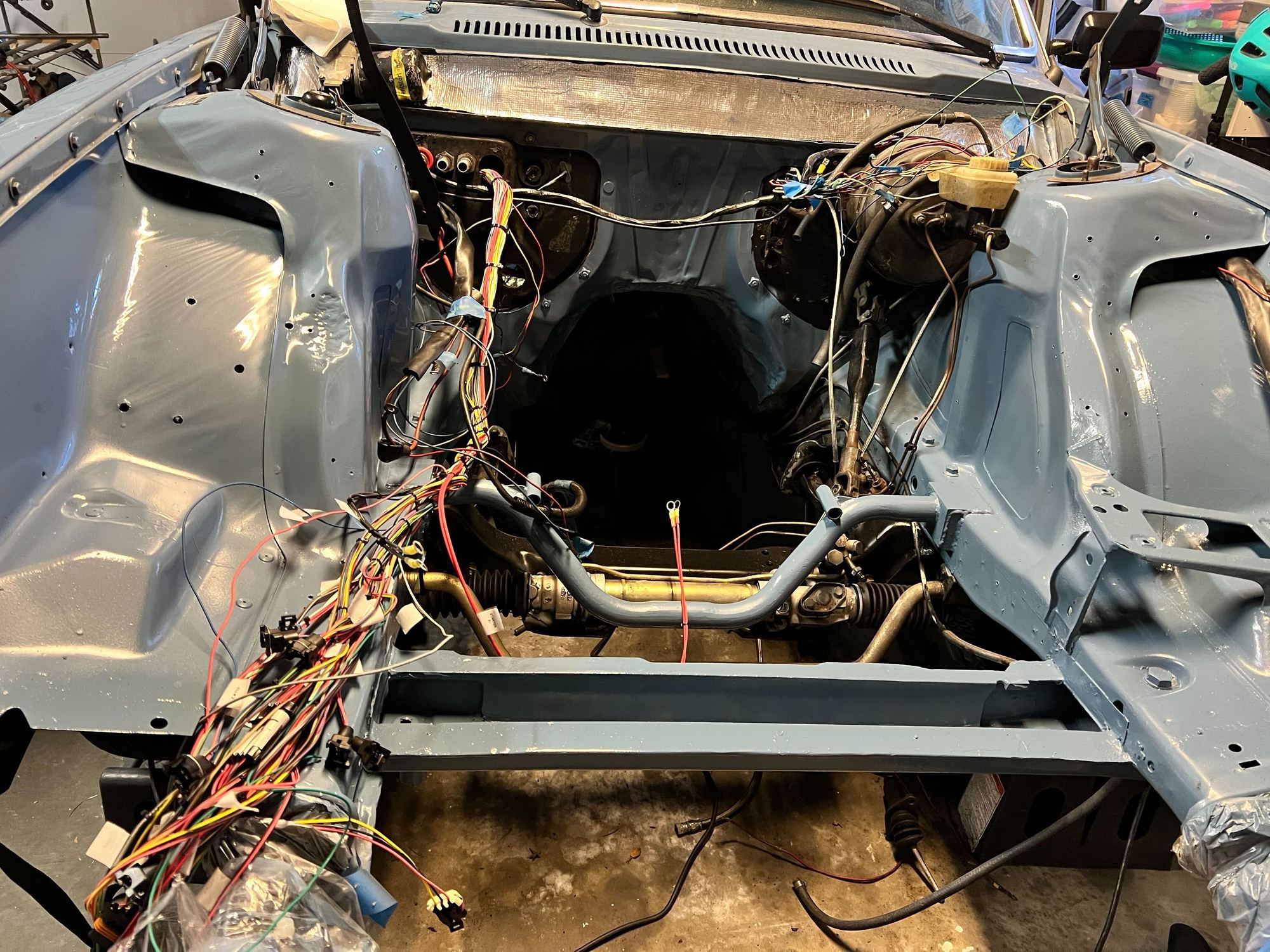

Lots of work on cleaning and painting the engine bay. Getting the Painless harness setup and connected.
