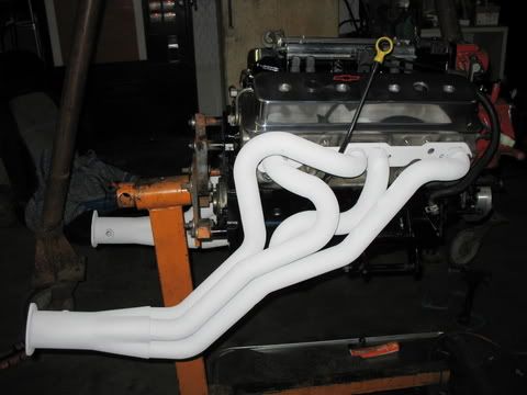

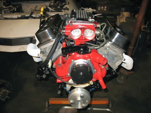

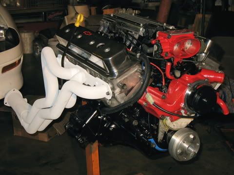

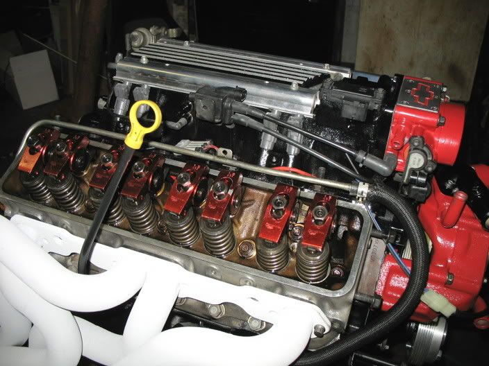

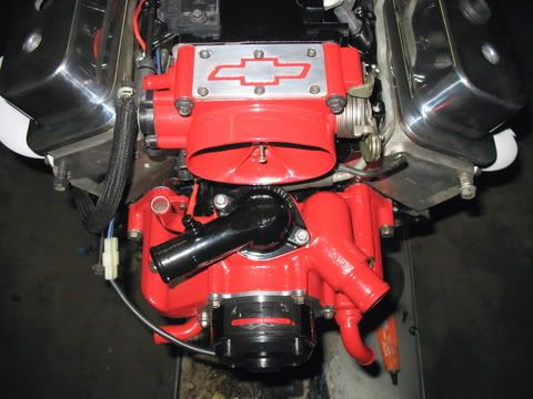

Thought I would post pictures of the project me and the pops have been working on. This is the LT1 out of his car, it was in alot better shape, less miles and some performance upgrades already. It had 1.5 CC RR's, custom bored 52mm TB, and a set of double springs with dampner but with out the inner spring. We put in a CC 510/520 230/236 @ 50 Hydralic cam, CSR Electric water pump, CC's rev kit, and Hooker LT's. This goes along with a K&N CAI, ORY, TLCC coil per cyl converter, and adjustable pressure regulator. Here are some pics. The parts you see were powder coated by us. New machine our first time doing it.... Oh and the Hooker LT's were sprayed by a local machine shop with an Aluminum spray that will never wear off, thats why they look white. I did this for the life of the headers and it seems like the aluminum would disipate more heat.

Where did you get the throttle body plate?
Old Feb 3, 2006 | 12:08 AM
1BadZ95's Avatar
Joined: Oct 2005
Posts: 410
From: Corpus Christi,Tx.
Re: LT1 Project pics.
My pops made it by hand out of a piece of aluminum he had.
