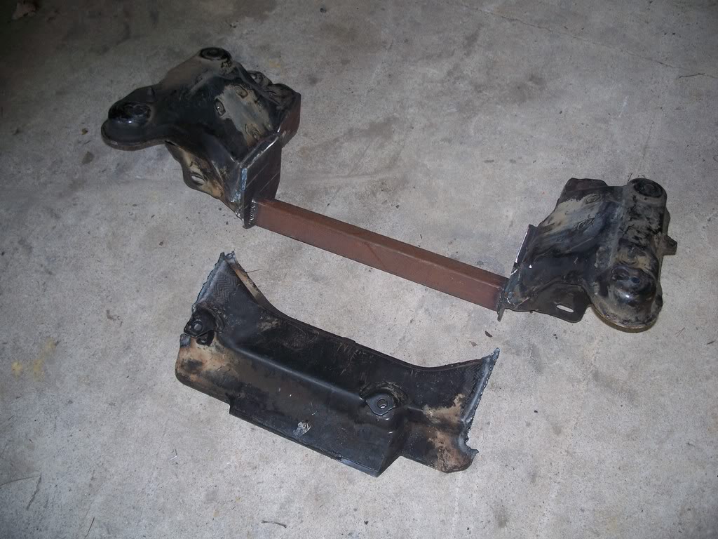

Guys is this an LT1 Kmember or a V6 Kmember??

hard to tell the lt1 bolt spacing is 1.5" on the two top bolts on the drivers side the v6 spacing is 3.5" on the two top bolts
let me look again to see a better difference
Old Jul 14, 2008 | 07:34 PM
slowride94z's Avatar
Joined: Aug 2007
Posts: 746
From: Bennett N.C.
99% sure it is a lt1 the frame mount for the lt1 is low close to the rack the frame mount for the 6 is high close to the frame of the car
The reason I had a hard time was the v6 kmember I have has a bbc in the way. The lt1 kmember I have is in front of the car
cut up v6 member " old picture "

If you look at the bottom of the K member there should be "3800, V6, V8" written on it by hand with paint. If it hasnt rubbed of that is.
