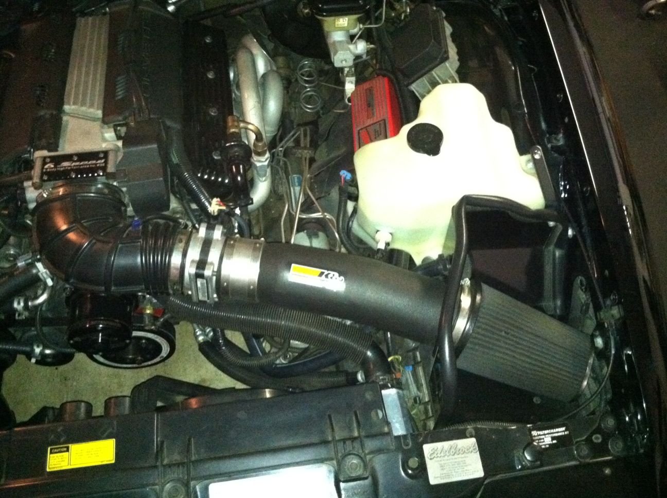

The reason the stock rubber elbow has "accordion" pleats in it is so it can flex to accommodate the normal movement of a V8 engine. Using those solid type elbows, let alone heat soak prone, with the short rubber flat couplers does not allow enough engine movement which will pull intake connections apart be it K&N FIPK or a SLP cone deal
If the K&N rubber grommet has been deformed in attempts to keep it tight that part may be a loss cause but if not just heat it in boiling water some so it is more pliable and then install while hot and ideally it will then conform and hold securely when using a stock factory elbow
I eliminated my K&N grommets and just clamped filter to tube and tube to MAF using a SS pipe clamp I got at Home Depot for $3 and MAF to elbow. This moved my MAF closer to TB and I got a MAF extension harness. This was on a B body but I suspect you could do the same with F Body LT1
Either way just use the stock LT1 elbow.

a CAI and better flowing exhaust are the 2 most basic power improvements you can do for any motor. Just a CAI or just a better flowing exhaust on their own is marginal power gain. Together they are "supporting" mods which allow both to function better together. More air in, more air out
With this said whatever "advertised" HP gain a intake company or exhaust company makes...divide by 2 for a more accurate "real time" HP gain.
You can throw bigger valve heads that are ported on a motor but without upgrading the intake, exhaust, cam, injectors, TB etc....the heads alone will be chocked and not provide the power gains on their own as they would combined with "supporting" mods. CAI is just one of the most basic mods but alone it is not much HP improvement
