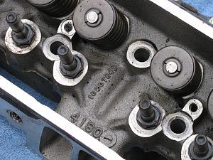

Are these #'s somewhere on the heads in a 3 digit only place or are they part of a bunch of #'s?Many thanks.

There is a complete casting number on top of the heads near the valve springs, and those would be the last three digits. I'll post a picture for you later in the day.

Casting 10207643
