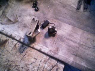

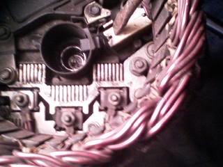

So I took the alternator apart. I was thinking I could just replace the bridge rectifier, but when I took it apart I noticed this.
In case you can't see it from the picture, this piece is broke to pieces in there and the springs were all over the place.
I don't know what this piece is called or what it does, but could it be causing the problem?

Figured out that it's called a brush holder. Sounds pretty important in transferring current, so I'm going to replace it to see if it helps.
Old Jul 22, 2009 | 10:27 PM
shoebox's Avatar
Joined: Dec 1969
Posts: 27,727
From: Little Rock, AR
Yeah, those are the brushes. It won't work without them.

Don't the brushes always pop out if you seperate the case?
Old Jul 23, 2009 | 08:17 AM
shoebox's Avatar
Joined: Dec 1969
Posts: 27,727
When you pull the armature out, the brushes may pop out, because they are spring loaded. The holders should stay in place, though. When you re-assemble, there is normally a way to push the brushes back in and "pin" them from the outside, so you can insert the armature. You then remove the pins to release the brushes. Usually a paper clip or small nail can be used as a pin.
Old Jul 23, 2009 | 10:15 AM
raroz28's Avatar
Joined: Feb 2005
Posts: 1,326
From: Metro Detroit, MI
But if you notice the brush holder is broken where it bolts on, so once it snapped, the springs go both ways, pushing the brush holder away and losing the connection.
