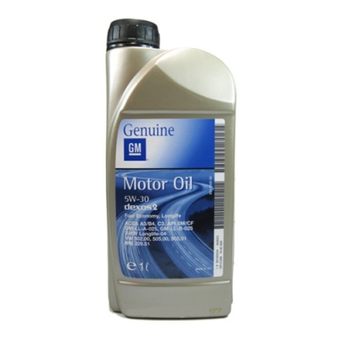

Okay, I will try that with the other oil gradation, but I doubt in oil last time put in, I will attach the picture just to see, I think it was the whole bad batch of this oil from the supplier
