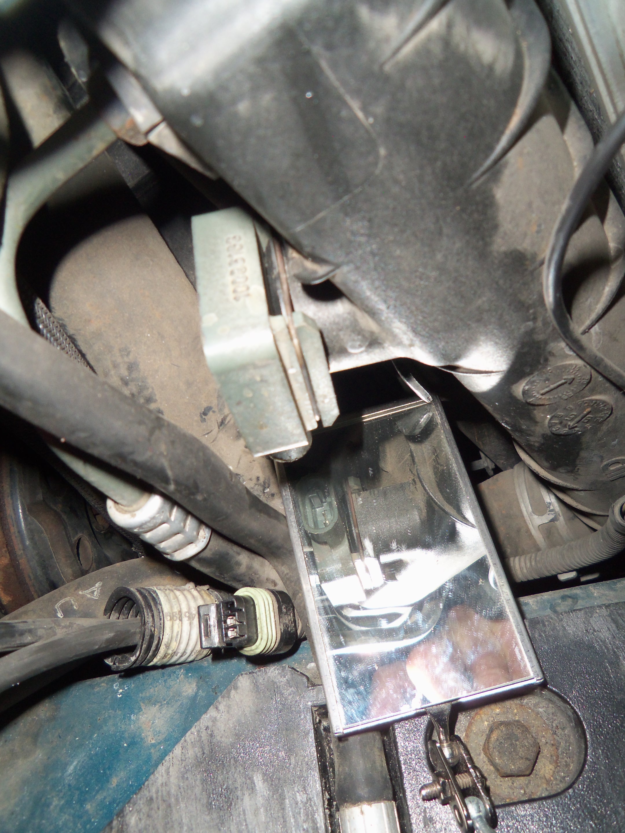

Here is a photo for reference, it is held in place with a wire like clip.
