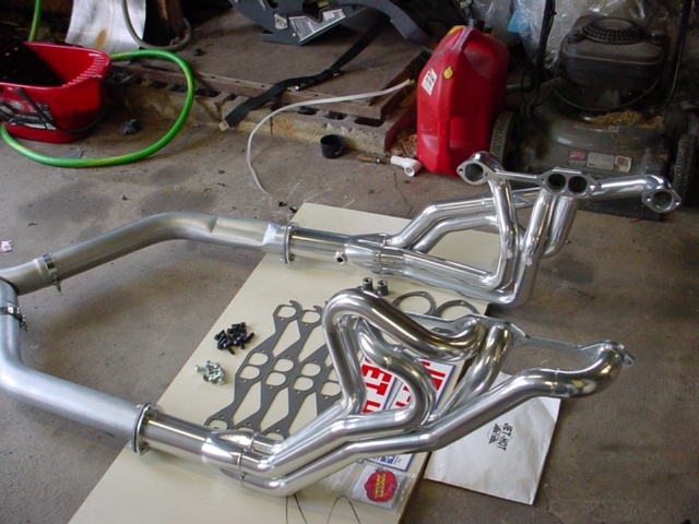

I have jet hots and mine are the same on both sides, I have a hooker Y pipe that is notched for the brace thats there.
