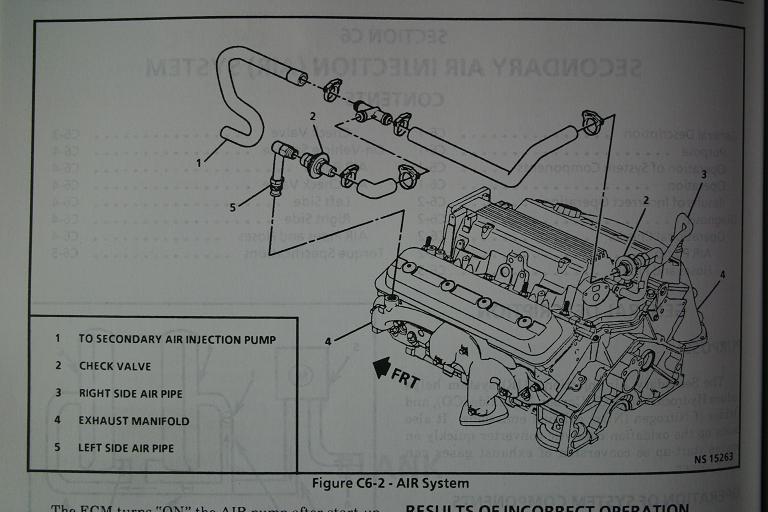

In the 93's, the plumbing for the AIR and EGR is in fact combined, and not the same as 1quickta described for the 94-97 cars. The AIR and EGR systems connect behind the back of the intake manfold, and the tube that runs from the passenger side exhaust manifold to supply the EGR valve is also used to flow AIR into the passenger side exhaust manifold.
From Streetlethal:
As a minimu, you need to cap off the place where the metal tube from #8 connects to the back of the intake manifold. Removing the EGR valve is optional. If you remove it, you have to cap it, and you need to cap the vacuum source on the drivers side of the intake.

Do your headers have the connections for the EGR and AIR systems, or don't they? You said there are no AIR connections, so that would mean the metal tube labeled "P. Side Header" has nowhere to connect. If you can't connect that line to the header, your EGR system will not work. So leaving the EGR valve there is totally optional. Remove it and you save 1# of useless weight. Leave it connected and you don't need that blockoff plate.
In any case, you MUST block off the back of the intake where the pipe labled "Intake" connects.

Read what I've posted twice already. You need to block off the connection labeled "Intake". If you do not do this, the engine will appear to run fine, when the ECM is not activating the EGR valve (does not actrivate at idle, not used at WOT, not used above 3,600rpm). But when the ECM activates the EGR valve, you will have as large vacuum leak from the tube connected to the back of the intake. And if your EGR valve does not seal well, you will have a vacuum leak all the time.
If you're happy with the way it runs, and not concerned abuot a vacuum leak, just ignore it.
