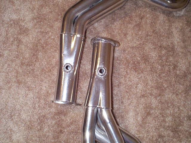

Here is the most common location for the O2 bung.
http://www.bfranker.badz28.com/misc/o2fittings1.JPG
They point towards the center of the car.

Well, I have the Mufflex y-pipe and purposely drilled holes and installed O2 bungs in my headers. I now have spark plugs in my Mufflex y-pipe until I "redo" things and put an actual plug in there
http://www.bfranker.badz28.com/fbody/exh-0715_IMG.JPG
