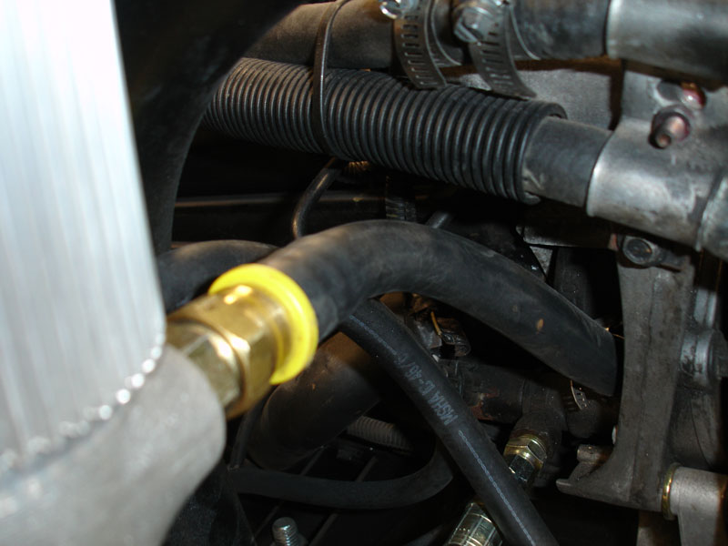

This is my suction line from the pump.

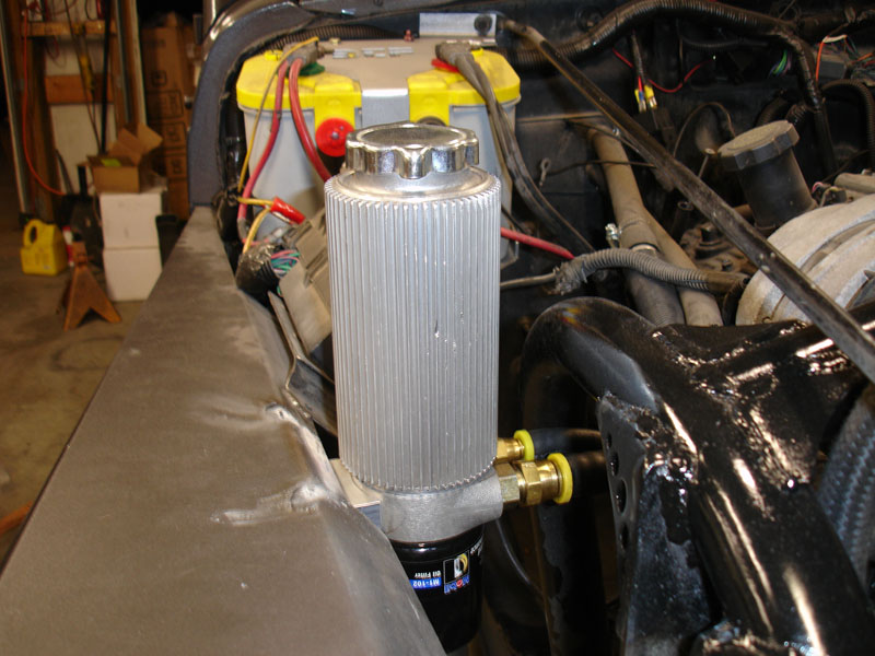

The pump draws fluid from this reservoir. It is finned aluminum and made to dissipate heat.

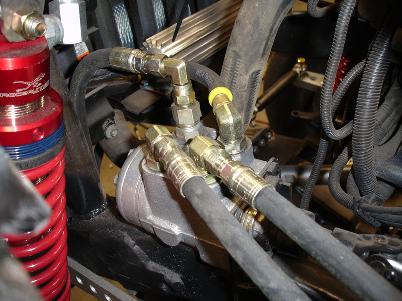

The pump feeds the orbital valve. This is essentially my "steering" box.
The orbital feeds a massive 2.5" balanced double ended ram which is what turns my tires regardless. This is the silver powder coated piece with blue end caps.
