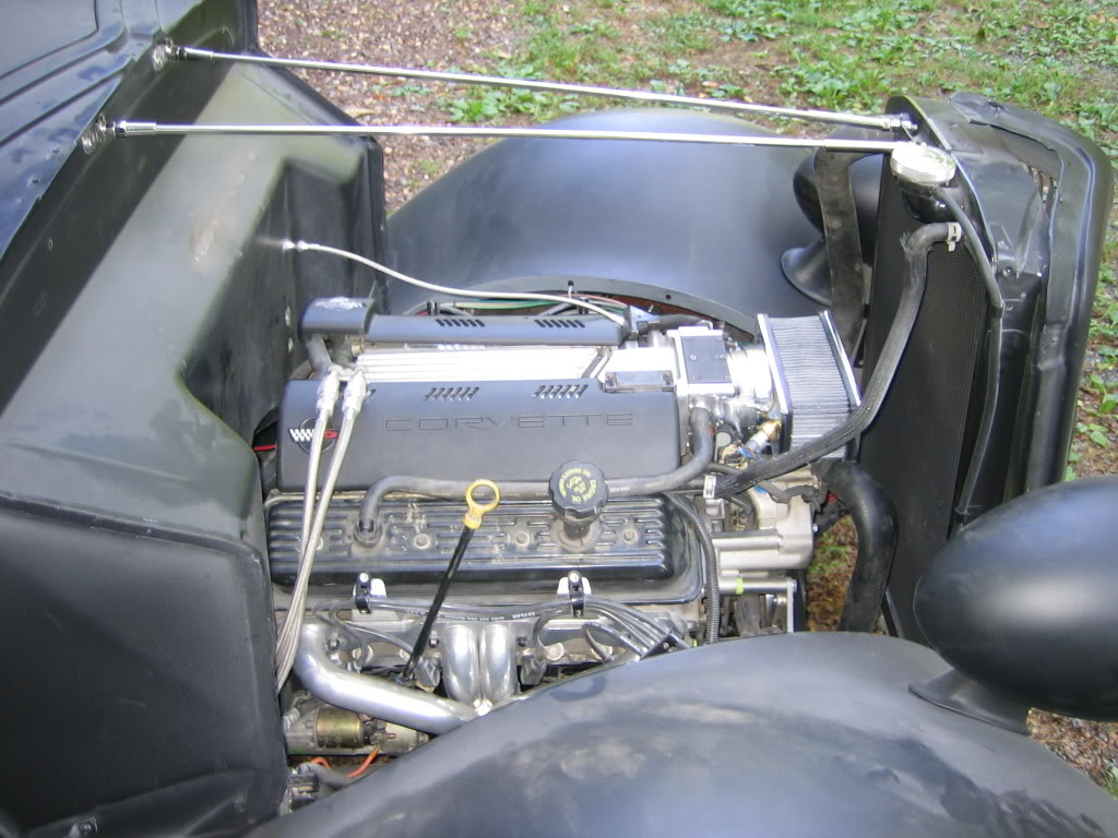

Here is the LT1 in my 35 Ford coupe. The engine bay isn't done yet, but it does run now
