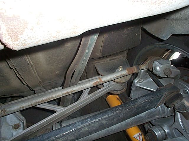

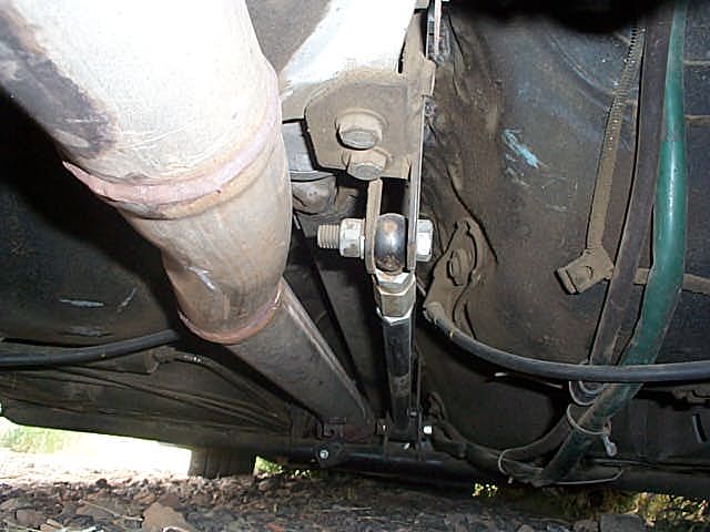

i can only talk from my experience with thirdgen camaros, but since the rear is practically unchanged, should be fairly accurate info. IIRC, GM did a two car IRS f-body project a long while ago, it was successful, but the extensive amount of modifications required for the retrofit is costly...to the tune of about 5k, you have to use a c4 rear, as a c5 has a rear trans and won't fit. The gas tank and everything else should fit fine in stock location, you have to go to an aftermarket torque arm because the c4 uses a torque arm mounted on the passenger side...i'll post a few pics of another private install...
GM's projects were done on 91 Formulas
http://www.transamgta.com/FireFox/
one of the private shops has one poor small pic here
http://www.rareautodesign.com/ManIRS.htm
hope this helps
