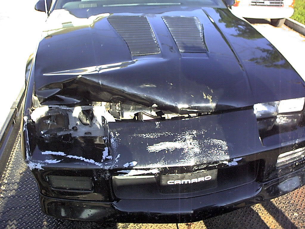

It has been YEARS since I have messed with my old TPI Iroc. There is a mod you can do to take out the baffeling in the intake track, which is suppose to increase the air. There could be a problem with water, though. I never did get to test it out or even do the mod. A deer took care of that for me.
