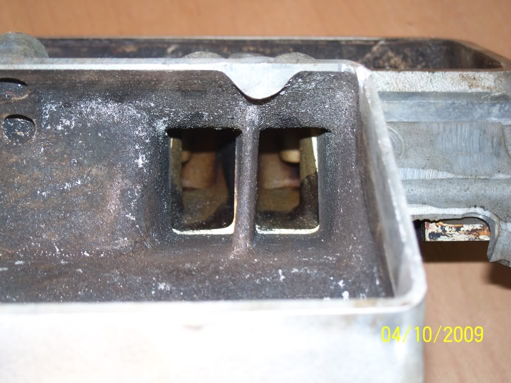

OK, Not a big deal and the car runs fine. Checked it with a mirror and light on each intake port.
I just wanted an idea of what I might be doing to my HP numbers knowing that the head is about 1/16" smaller on the bottom and 1/32" on the top. Vertical sides seem to matched up very well.
From a basic standpoint, I know it shouldn't really impact my running. However, I know the theory is to have smooth flow through the port and a disturbance will impact that flow and thus speed of the charge.
Since I intend to push the car to 6700 RPM this coming race season, I am wondering if it is worth it to get the heads cleaned up since they are out. I regularly keep the car in the 4-6K range when racing so the upper end is where I am concerned.
I just don't want to shell out money for additional port work (it has been done before) if the HP will not matter (less than 20 lets say).

So, to paraphrase, the ports in the heads are smaller than the gasket and the intake manifold...is that right? I'm really surprised that ported heads aren't already gasket matched.
Whether the ports in the heads or the manifold are smaller doesn't really matter...you can gasket match either yourself to improve flow. However, the tiny difference you're talking about probably won't net you 20 ponies
:THUMB:
I am surprised also on the matching but what is most interesting is the intake (essentially untouched) is larger than the gasket itself. Kinda wierd.
I have a dremel so could do "something" but without a junk head to practice on, not sure if I want to get too aggressive.

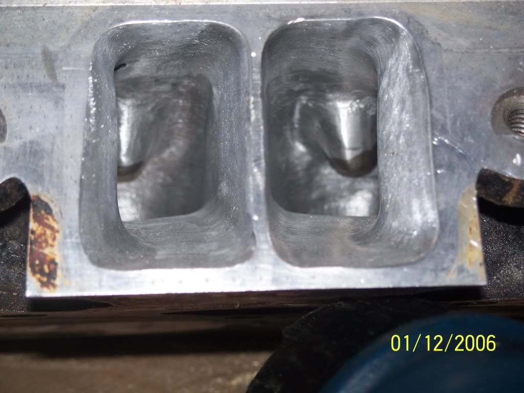

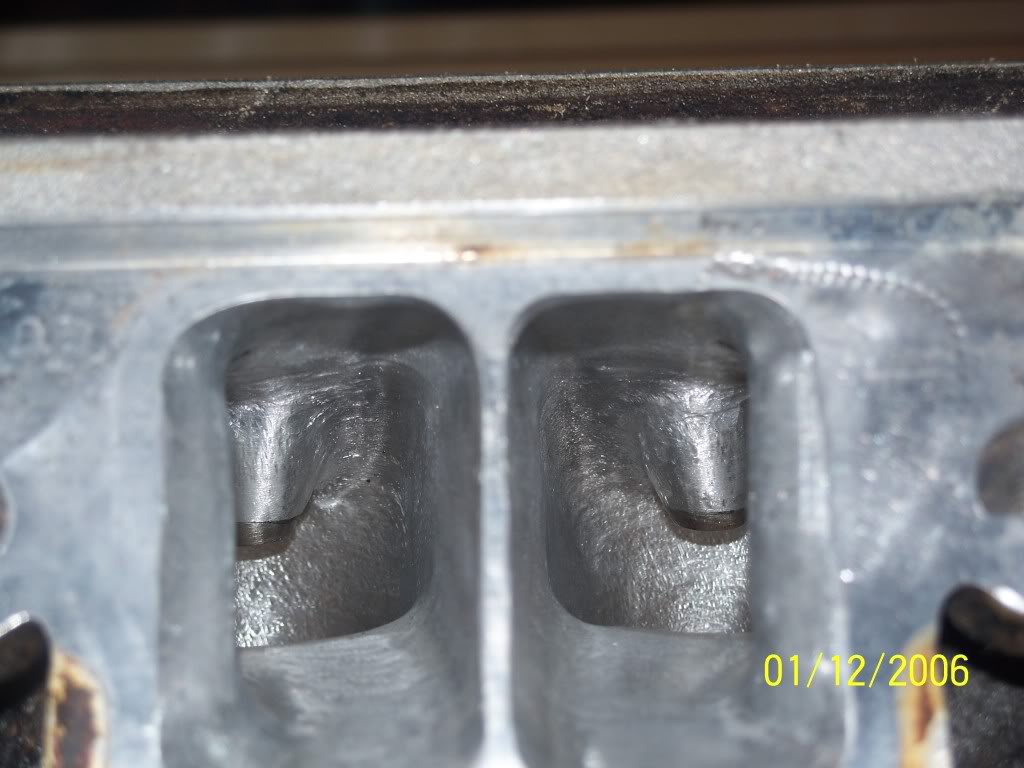

look like these?
https://www.camaroz28.com/forums/sho...d.php?t=680229
https://www.camaroz28.com/forums/sho...d.php?t=681965
Iv cleaned the ports up since but no new pictures
look like these?

check out this post. I did what they said and moved my burr quicker and side to side on a 45* angle then some home made cartridge rolls
for just port matching like your talking about just use the kit your talking about and scribe the port with an awl using an intake gasket, a burr takes off aluminium too quickly sometimes . blend it back about an inch
Ill go take some pictures
