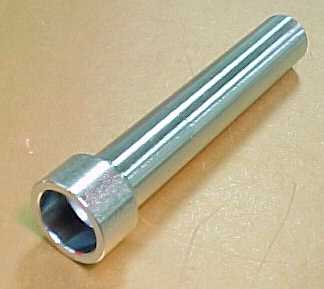

Like this:
Plastic one looks about the same.
Old Dec 30, 2007 | 04:19 PM
Stl94LT1's Avatar
Joined: Apr 2006
Posts: 1,083
From: O'Fallon, MO
Originally Posted by SS RRR
Like this:
That's it!!
