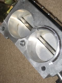

So I had my engine builder machine out an area of the BBK TB so we could then machine a plug to not allow idle air into the large main plenum. The plug was drilled to force all idle air into the small hole on the front of the TB and into the small holes in each runner just like GM had intended for the LT1.
Here are some pics of my TB mod:
Final result.
128/128 BLMs at idle 95% of the time.
Final result.
