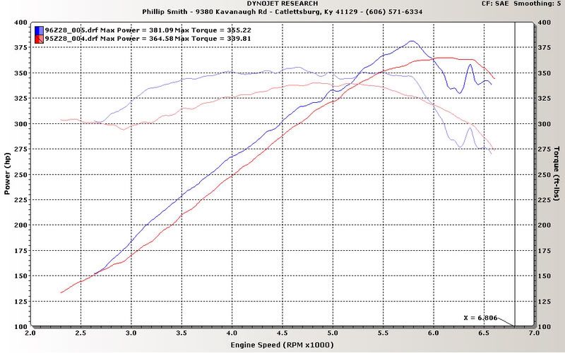

Those heads might be holding you back some. I did a set of stock 96 heads for a guy, they had 2.00 1.56's, 54cc chambers, with a custom spec'd 224/230 .604/.600 on a 108, ported the intake, longtubes, ported 58mm tb, through a cai and a stock 107k mile shortblock and made 381rwhp at 5700 on a stingy dyno. Valves started to float(spring needed .050 more shim) but was well on it's way to making 400+. So if you've got a good tuner i'd imagine you could atleast put down 380.
