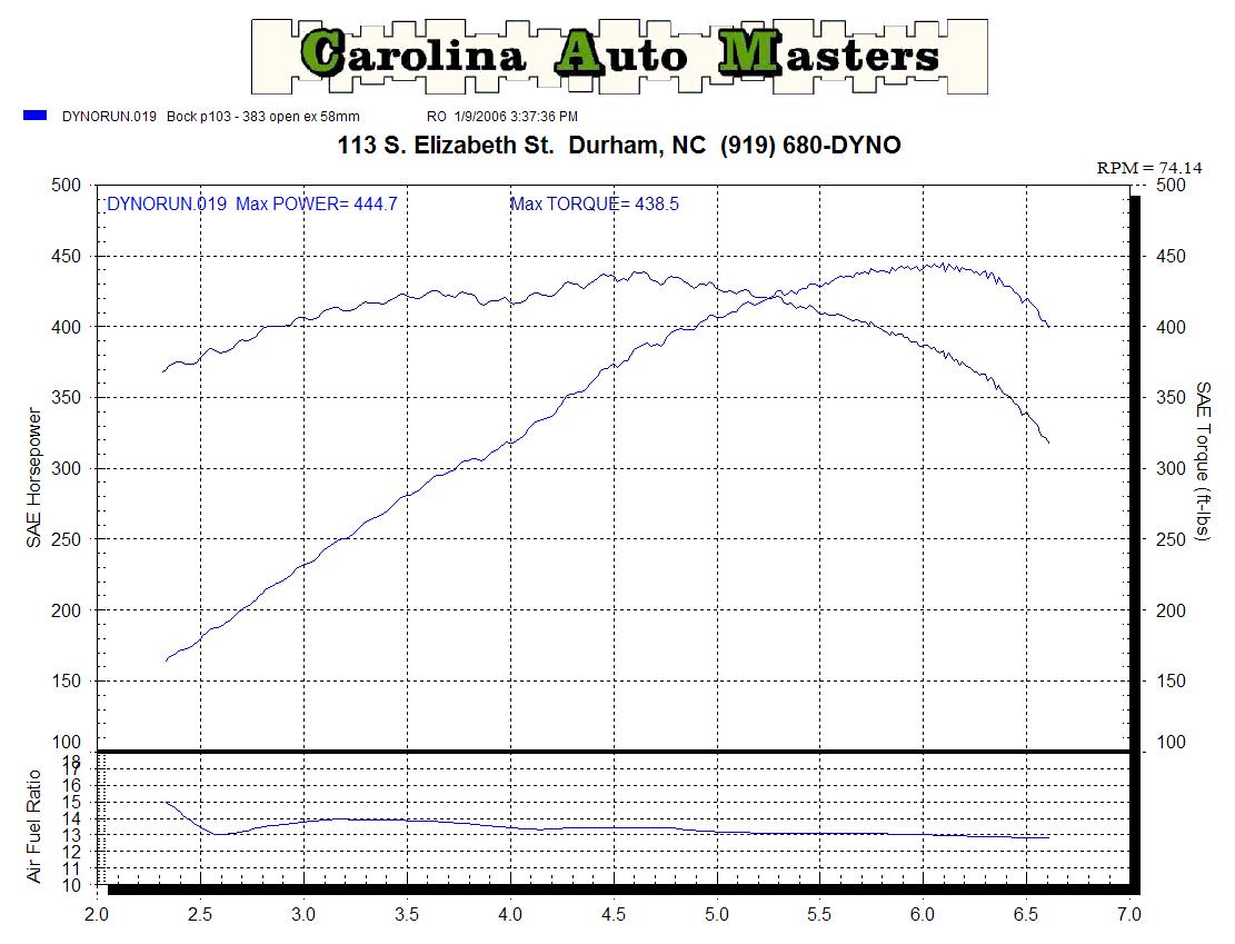

exactly 96caprice! I have a stroker, and I am going with ported stockers. The only reason you need aftermarket ones would be NOS or atmospheric modifiers! I have been talking with AI for about 2 months now, and I am getting my stockers ported. Not only is it way cheaper in the long run, it gets you right where you need to be! They have their stock casting porting down to a science! Team up their race ported head with their custom cam, Jeff Creech tuning, and they just pumped out a car that did 444rwhp, 43X RWTQ, and 26 MPG on the freeway! Now, who doesn't want that? Come on, 2500 for AFRS only half ported, or stockers ported for 1700 bucks. Plus, the cumbustion chamber isnt huge so you have to deck the crap out of your block, shave the sh*t out of the heads, and get big domed pistons. Mine is a 383 and this is the route I am going. Of course Trick Flows are a little cheaper, but then you have to do all the machining anyway...
here is that dyno graph, used with permission of A.I. of course!
But, you can't preach to the deaf. I have been talking with hundereds of people about this, and I seem to run into arguments over aftermarket head castings all the time. It just seems from all the RESEARCH that for most street cars the aftermarkets are overkill. Now, go to the track only, and hell yeah bring on the aftermarkets! (if you are sponsored and don't have to pay for it!) )
So, I hope this helps, and I am not looking to get into an arguement! Like Ron from AI told me, "People are going to do what they want, and the customer is always right. But, if they would just listen then I could build them a better top end cheaper." Well, it was something like that, cuz I kept calling him and asking him about AFR and TFS. LOL he has put up with soo much crap from me, its amazing he still answers my phonecalls and emails!
