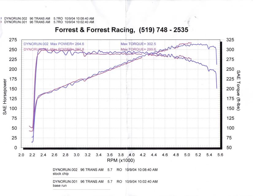

I used a Hypertech when my car was stock and heres the dyno with 160 stat program. The red show Hypertech and blue is stock. The only features I needed were the speedo recalibration for gears and fan temp settings. Otherwise it wasn't a power booster.
