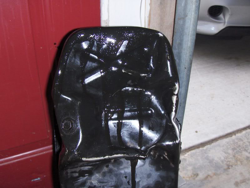

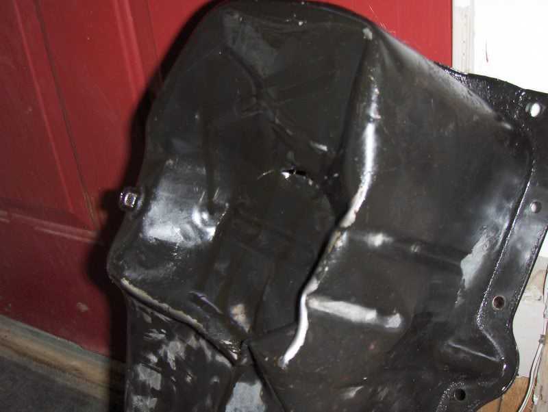

4. have the jack slip and dent the oil pan
5. Swear and throw tools and wake up your mom
Yeah im an idiot, but the good news is i got the old pan off w/o touching the K member or tranny. Jacked up the motor pretty high under the timing cover, but it came out alright. I still havent even started my car since the LT install, so lets hope everything works when i finally finish up the oil pan later this week.

So theres the pan, luckily i still had the stands under the pads so it only compressed the pan 2" or so.

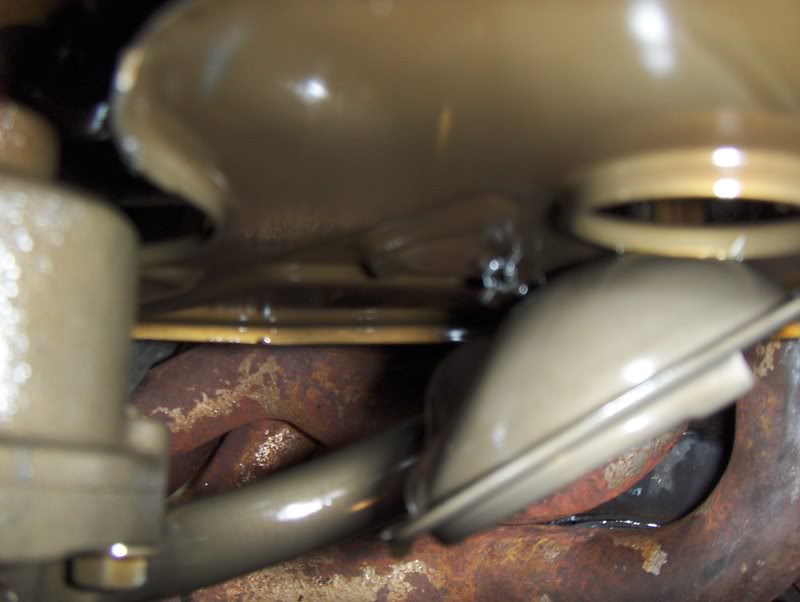

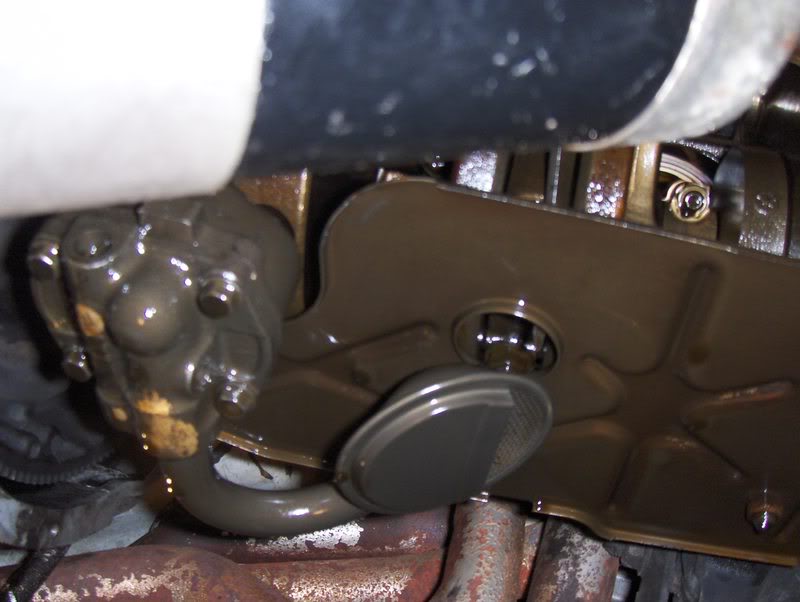

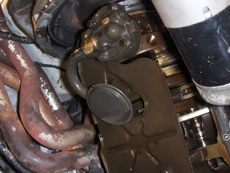

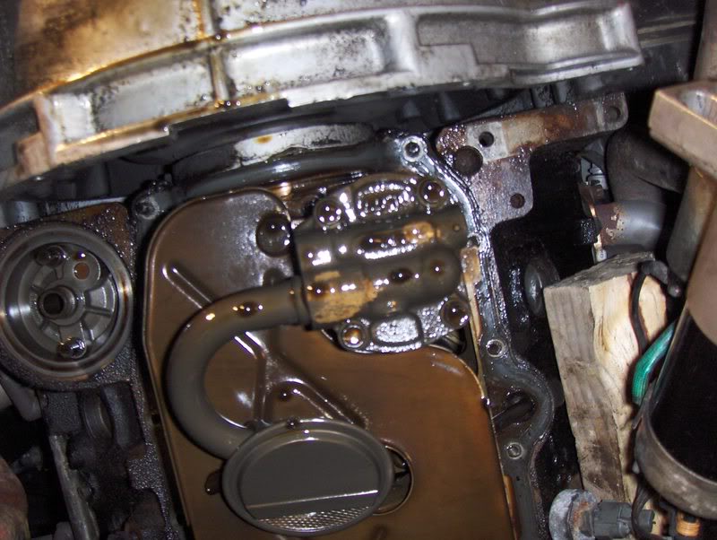

While i was under there i snapped a few pictures just to ask you guys if you think everything looks okay before i close it back up on tuesday. Also does anyone see any harm in leaving the engine jacked up for a few days?

Oil pump and pickup and everything looks okay right?
Just picked up a felpro gasket kit from AZ today. Any tips for putting in the new pan? Thanks guys
Old May 11, 2008 | 06:19 PM
Pontiac_97's Avatar
Joined: Dec 2007
Posts: 183
From: Michigan
i would replace the oil pump, pickup tube and get a one piece metal oil pump driveshaft while your in there. maybe 80 bucks total for all of that. if you dont decide to do this, the only thing wrong is you have to straighten the pickup tube so it sits parallel with the windage tray

Is that part of the oil level level sensor trapped by the pickup tube? The plastic shaft in the pan may be another part of the sensor.
Old May 11, 2008 | 10:16 PM
seawolf06's Avatar
Joined: Jul 2004
Posts: 3,034
From: Raleigh, NC
I forgot about that. That's probably right.
Old May 11, 2008 | 10:17 PM
Pontiac_97's Avatar
Joined: Dec 2007
Posts: 183
From: Michigan
good eye. i didnt see that. that definitaly looks like the oil level sensor. i can see the oil pump driveshaft and the plastic thing on that still looks in place(its red.) i think you broke the oil level sensor
