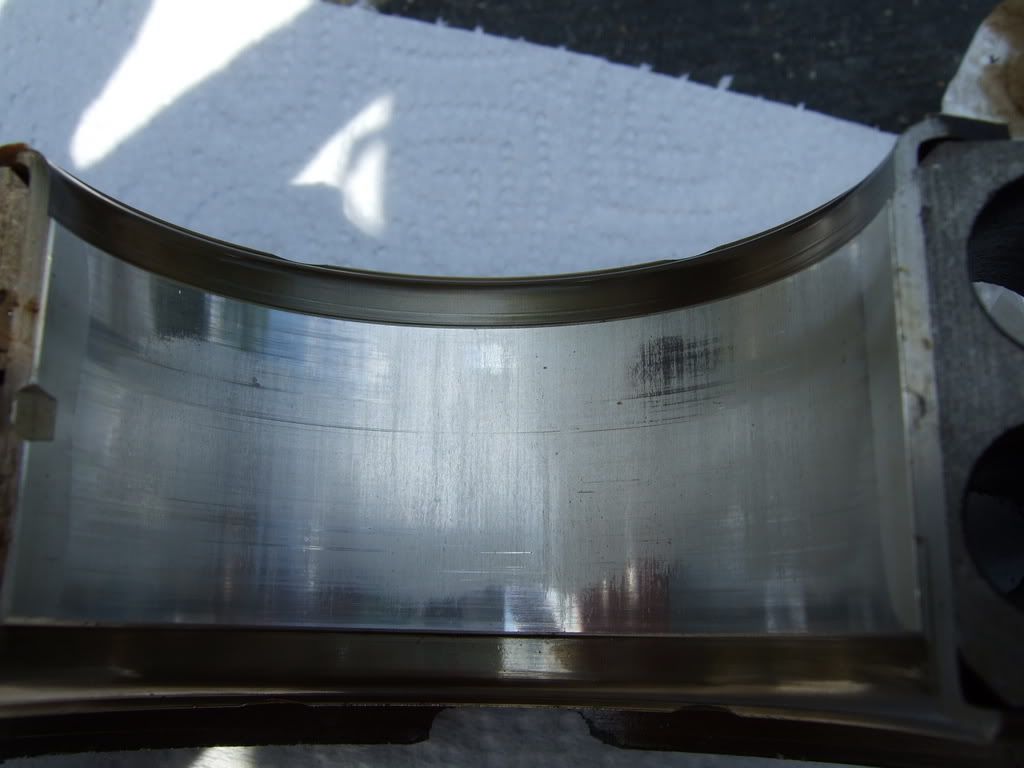

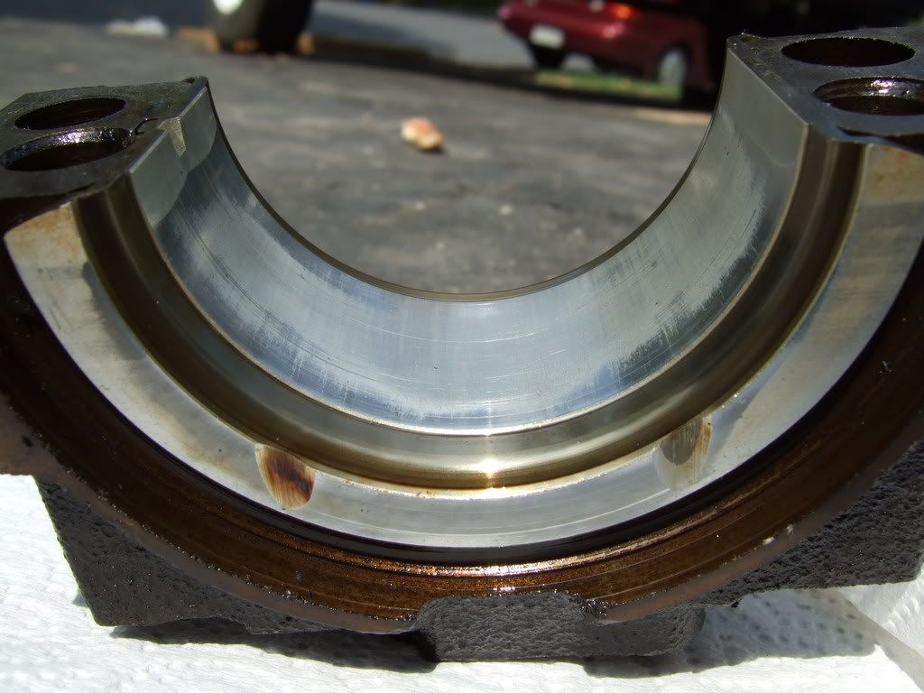

Well I pulled the rear main cap and here is what the bearing looked like:
I guess from the looks of that I need to inspect my crank aswell.....
I do I measure the bearing to figure out which size to buy?
Old Sep 5, 2007 | 03:06 PM
pizzi-man's Avatar
Joined: Aug 2007
Posts: 305
take your crank and bearings to a machine shop and have them look at it. They will be able to tell you how much if any has to come of the crank and how much of an oversized bearing you will need.
Old Sep 5, 2007 | 05:49 PM
rskrause's Avatar
Moderator
Joined: Dec 1969
Posts: 10,745
From: Buffalo, New York
You will likle need stock size bearings unless the crank needs to be turned. The only way to know for sure is to measure both the crank journals and the main bores. But if there has been no work done to either than a measurement shouldn't be needed. If the crank does need turining, most likely the bearing size can be based off of the journal measurement alone.
