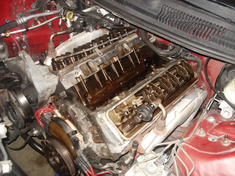

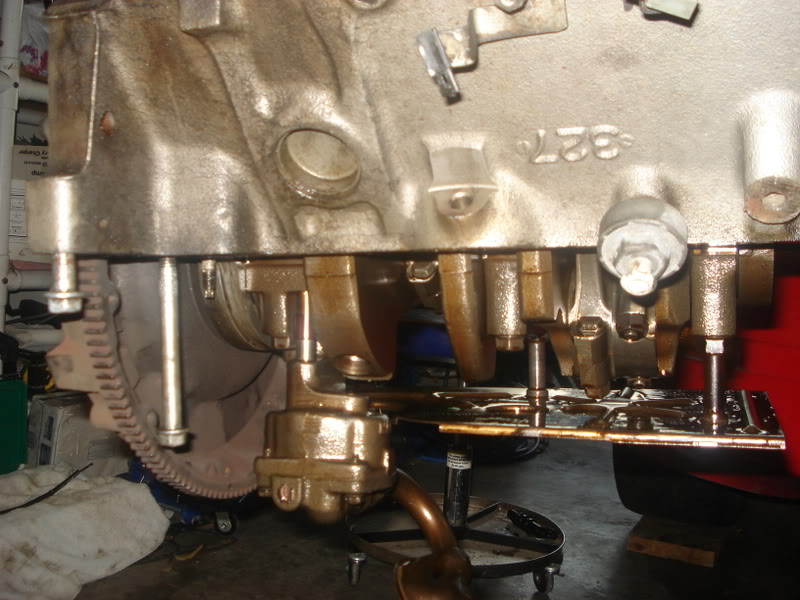

here are the pics of my block and some of the heads. if you zoom in alittle you can see the numbers. This is the 5.7 Lt1. ill take pictures of the intake tomorrow and post it.

Old May 12, 2008 | 08:06 AM
96capricemgr's Avatar
Joined: Feb 2004
Posts: 4,800
The 138 intake while found on L99s is not L99 specific. Matter of fact they are fairly desirable far as the Stock Eliminator guys are concerned so they can't be all bad.
I am running a 138 intake on my car with fairly light porting, if it is a handicap I wonder what this thing would do with the "right" intake.
My car came with an L99 and that is where I got this particular intake.
If it really bothers you though I can ask a couple of the Stock Eliminator guys if they are still looking for more 138 intakes and they could maybe trade you a different casting.
