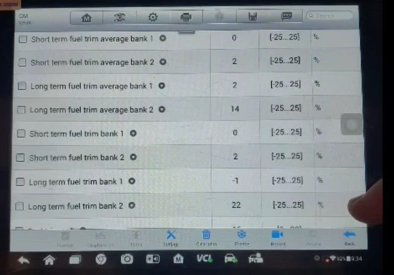

The LTFT at 25% is at the maximum value limit of the stock PCM tune, and still unable to add enough fuel. So the PCM is using the STFT to add additional fuel (not the STFT primary purpose). Since they are multipliers in the fueling equation, the system is adding about 44% extra fuel to meet the system's target A/F ratio of 14.7:1 in closed loop (non-PE).

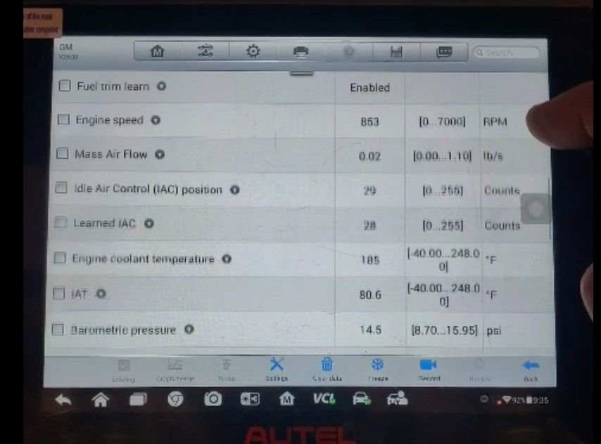

Thanks. I will try to detail as much as I can remember.
At hot idle:
MAF = .02 lbs/s
BARO press - 14.5psi/4.75v
MAP = 6.96psi/2.02v
IAT = 80.6
ECT = 185
Engine Speed - 750-850 on a 800 Set

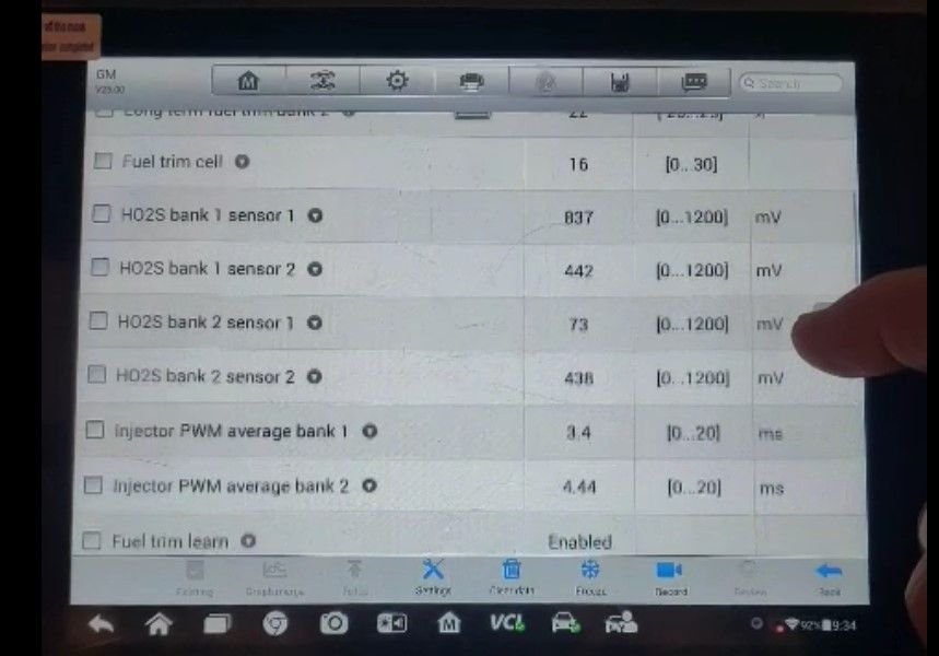

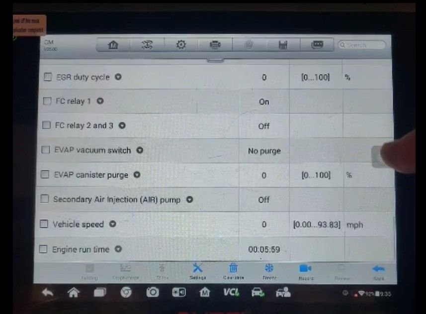

Ok, here is screen shots from the scanner video. Do these tell me anything other than Bank 2 is lean?
