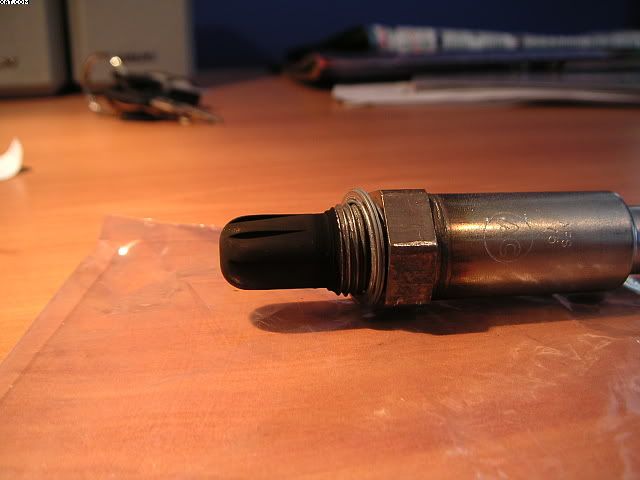

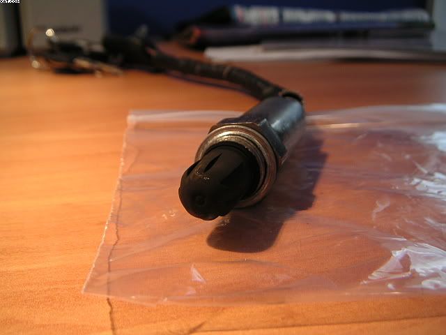

I pulled the driver side O2, and it's covered in carbon. Is this normal?

here's some pics.

Your car is running rich and fouled O2's again. There too many things, that can make it run rich. Like MAF is reading too much air, MAP reading load, EGR can be stuck, fuel pressure regulator can be bad, or vacuum leak. Do a search.

My driver side collector leaks, I'm positive. All of the other sensors look fine, I have some logs from 2 weeks ago. You can see that the driver side O2 is reading low, which = lean, which I can blame on the exhaust leak.

hmmm. I'm thinking your gonna have to patch that exhaust leak up. Your saying the 02 is reading lean, however its a false lean because of the escaping gas, which in turn will dump fuel to that side of the engine, which is the side in which you yanked that 02. So ya just patch that leak up and you should be good to go. BTW, what brand 02s are you using? Anything other than ACDelco is bad news.

Prolly just gonna have a new Y-pipe made Monday. They're AC Delco O2's.
